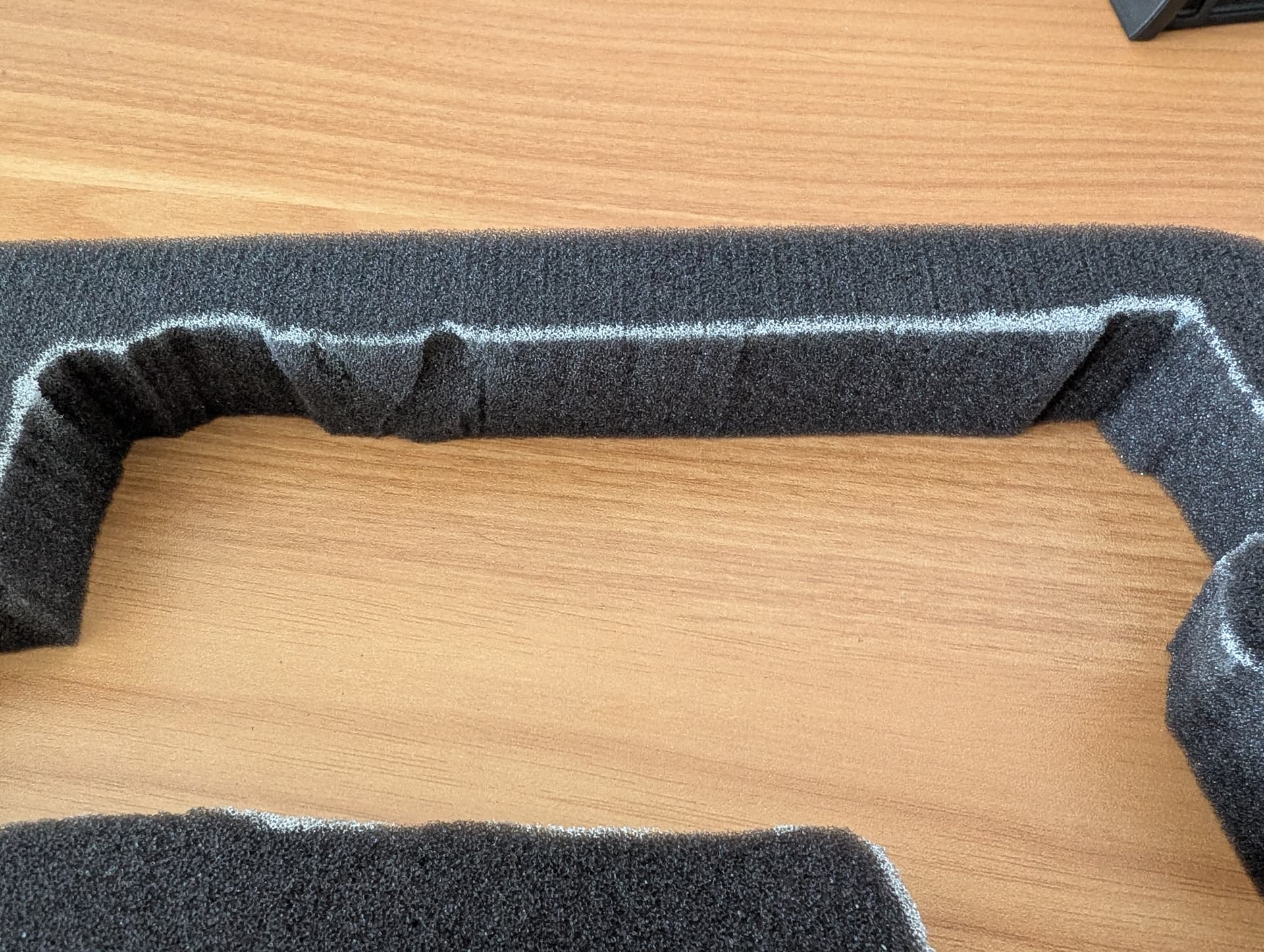

I can’t cut this straight for shit, using a razor to make initial hole, then fitting electric knife in, and going around, the issue for me is the corners, I can’t get them to look good, I fucked up 3 pieces of foam so far, any tips?

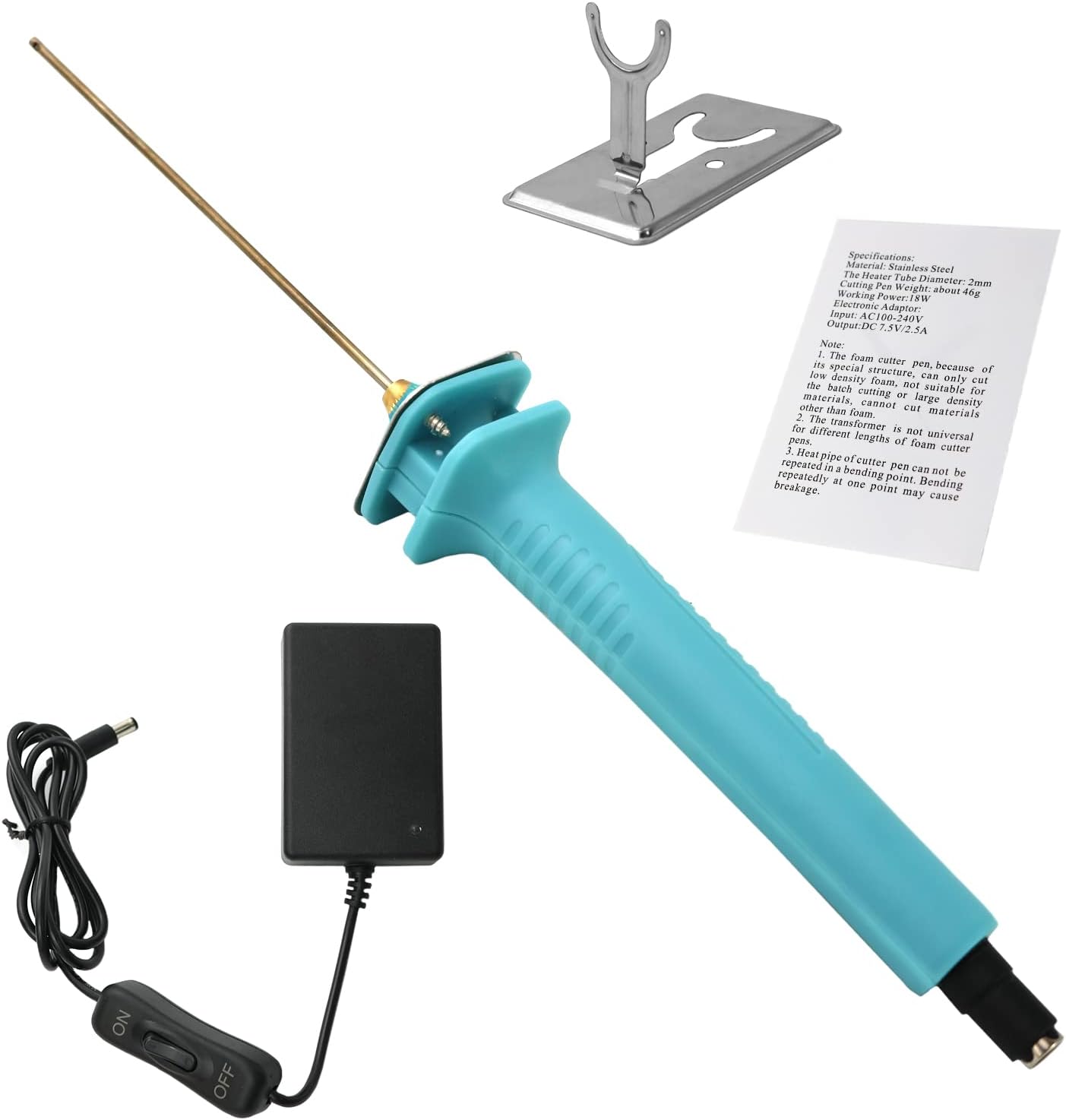

Have heard elsewhere that a “hot wire” foam cutter is what you need for precise foam cutting.
Haven’t actually used one myself, but if I was going to try similar to what you’re doing I’d get one (just googled, this came up first, no idea if it’s best or not):
Probably going to end up trying that

I am VERY tempted to get the Proxxon Thermocut 115/E if I can somehow justify the purchase lol, probably going to end up going with a pen though.

I think the hot wire cutter I bought was like $10 on Amazon.
I highly recommend this method, worked like a charm.

I tried but I just don’t do well on the corners with it, also have a hard time holding it straight at a 90 degree angle, I feel like it’d work better for bigger foam

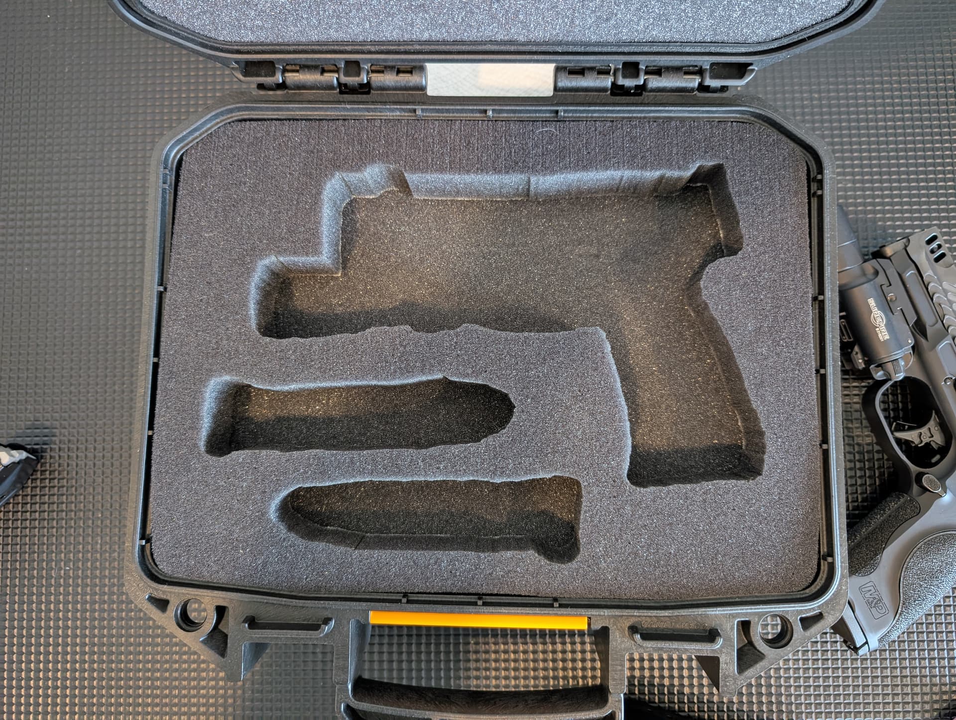

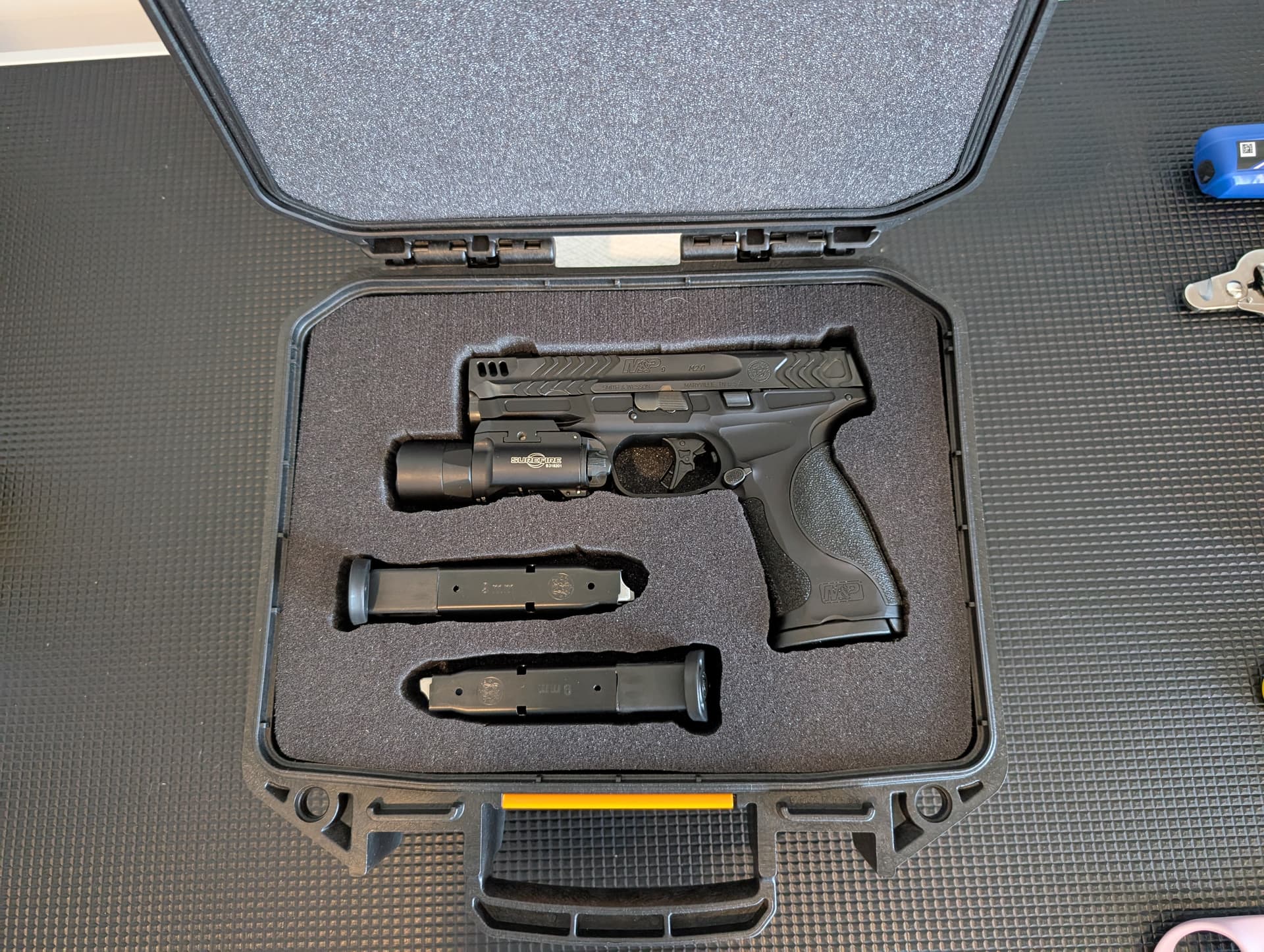

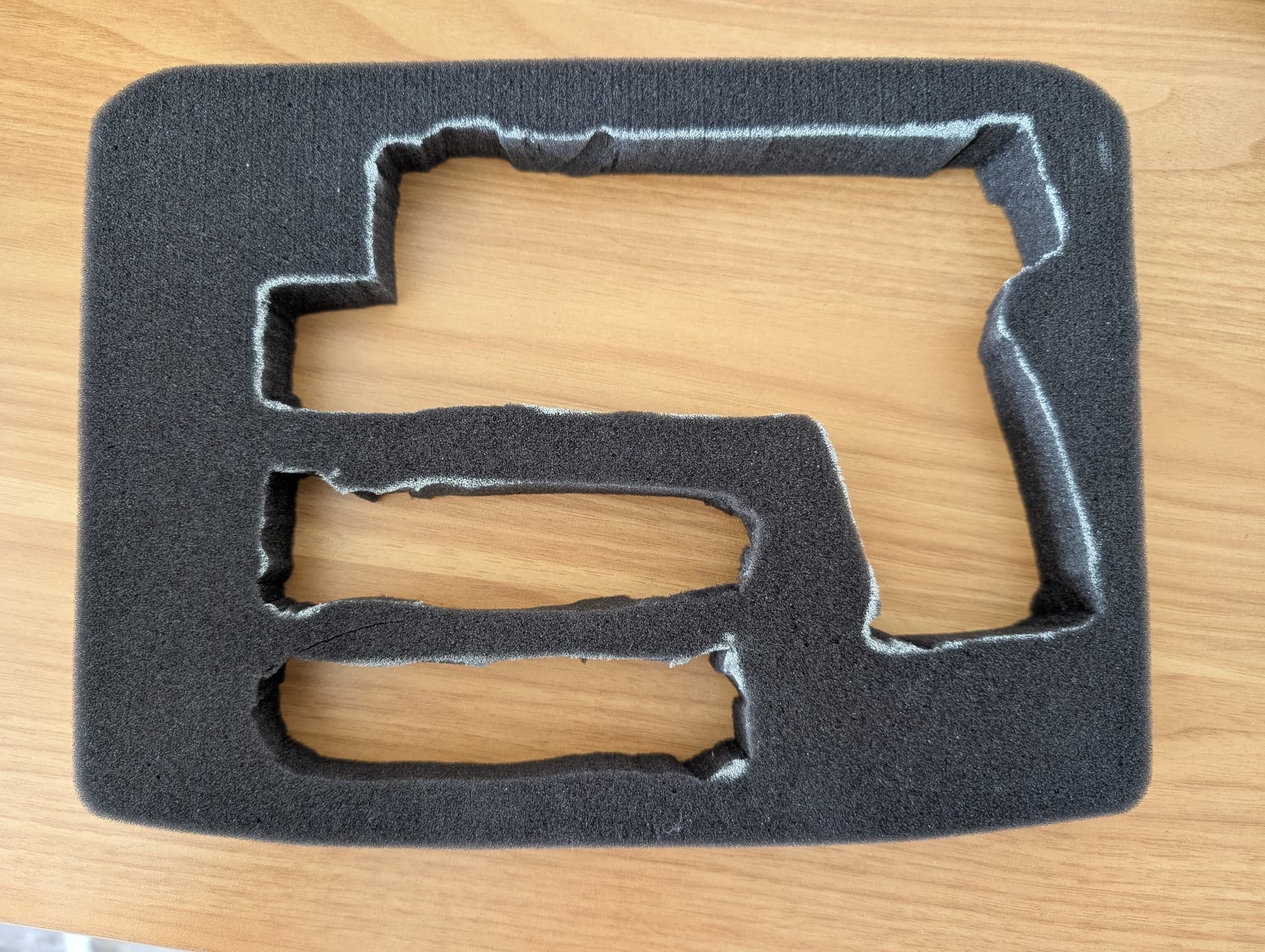

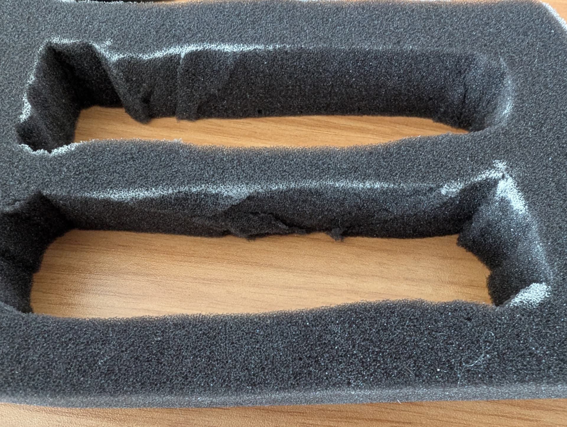

Bought a proxxon thermocut 115/e wire cutter, and it’s the best that anything’s worked, still not perfect, but that’s on me, and I’m happy with how it came out (Except the mag cutouts but fuck it I’m not re-cutting)
Looks good.
