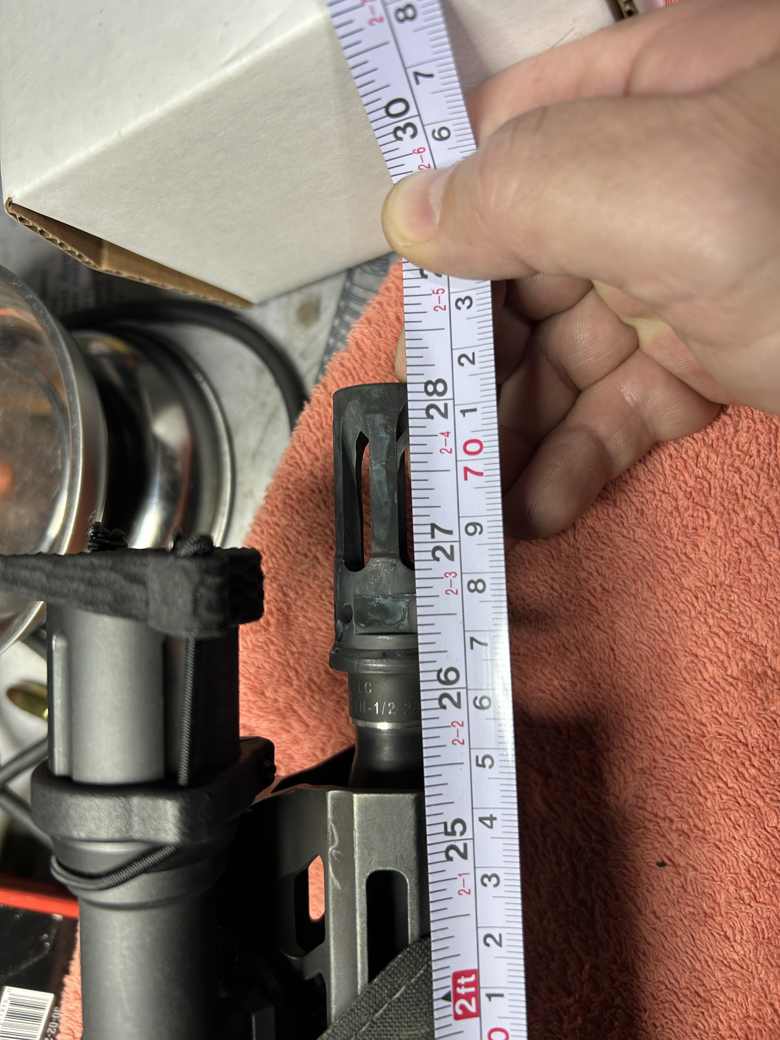

If you want a total overall length of 26” and you want a muzzle device, it makes sense to me to have a barrel cut to the appropriate length to make that particular muzzle device end at exactly 26” overall when timed and pinned.

I have a MM Wartime SBF. 11.75” barrel, standard receiver extension, makes it 26.125” OAL without the muzzle device. Has a SF Warcomp that brings it to about 28.125” OAL. I always assumed it was unpinned, but I never asked.
Others are measured from End of the Buffer tube to the end of the barrel W/o the muzzle device
