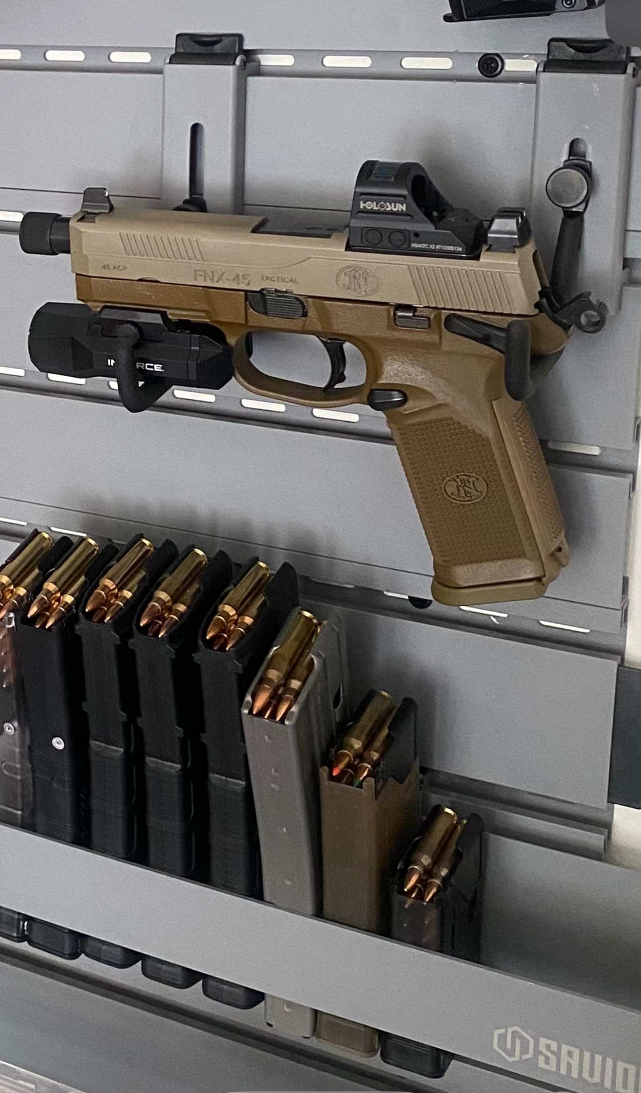

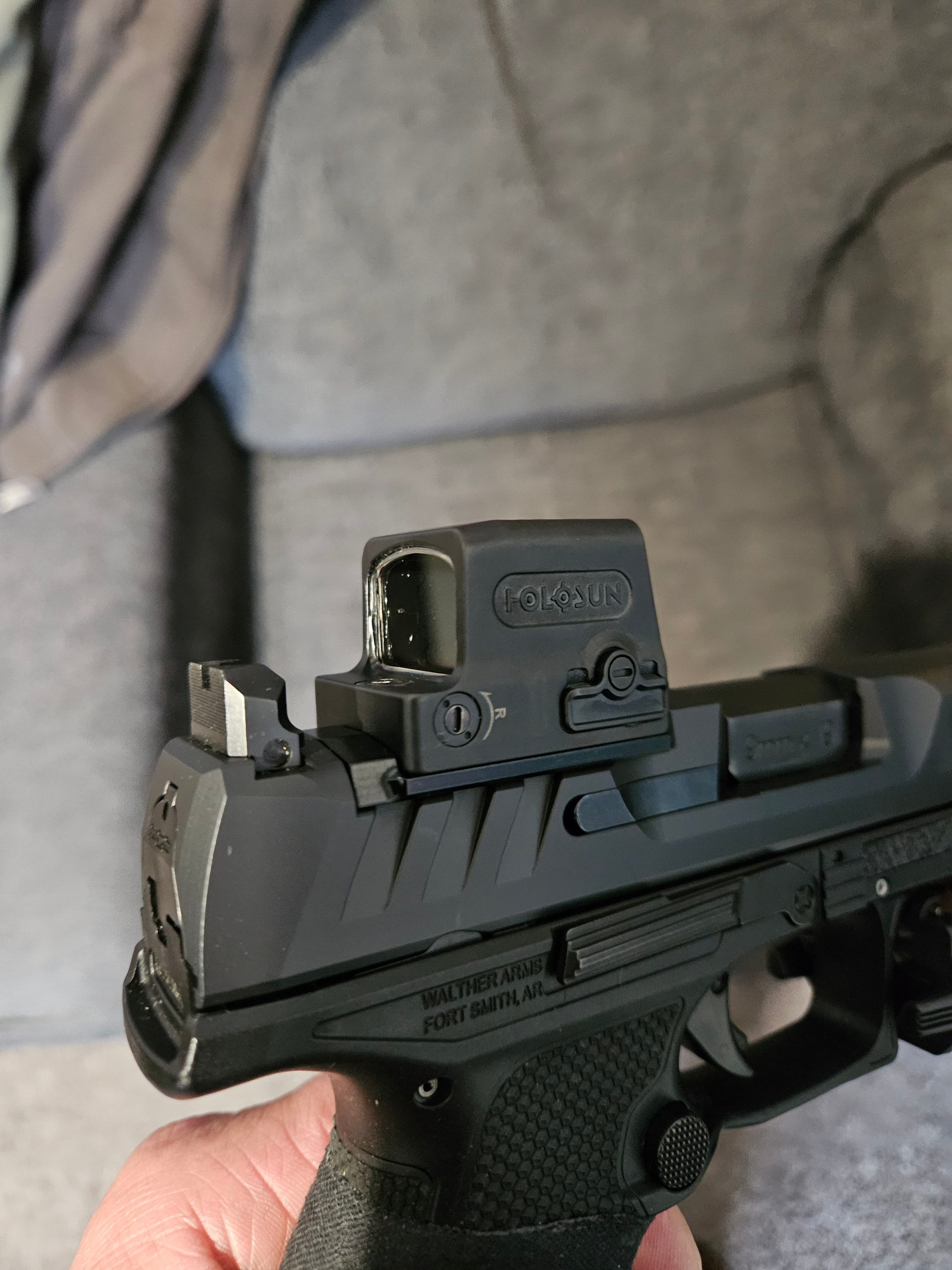

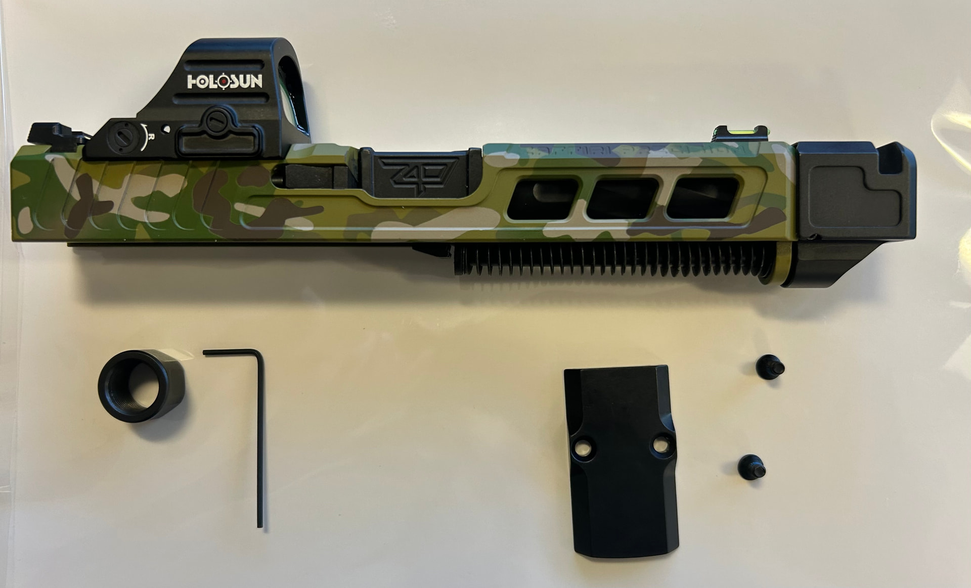

I put Holosun 509T on my shtf Walther. Excellent RD.
You definitely need a plate for mounting and suppressor height irons though.
Is that the CH plate?
The FNX45T comes with suppressor height irons.
Pretty sure it is.

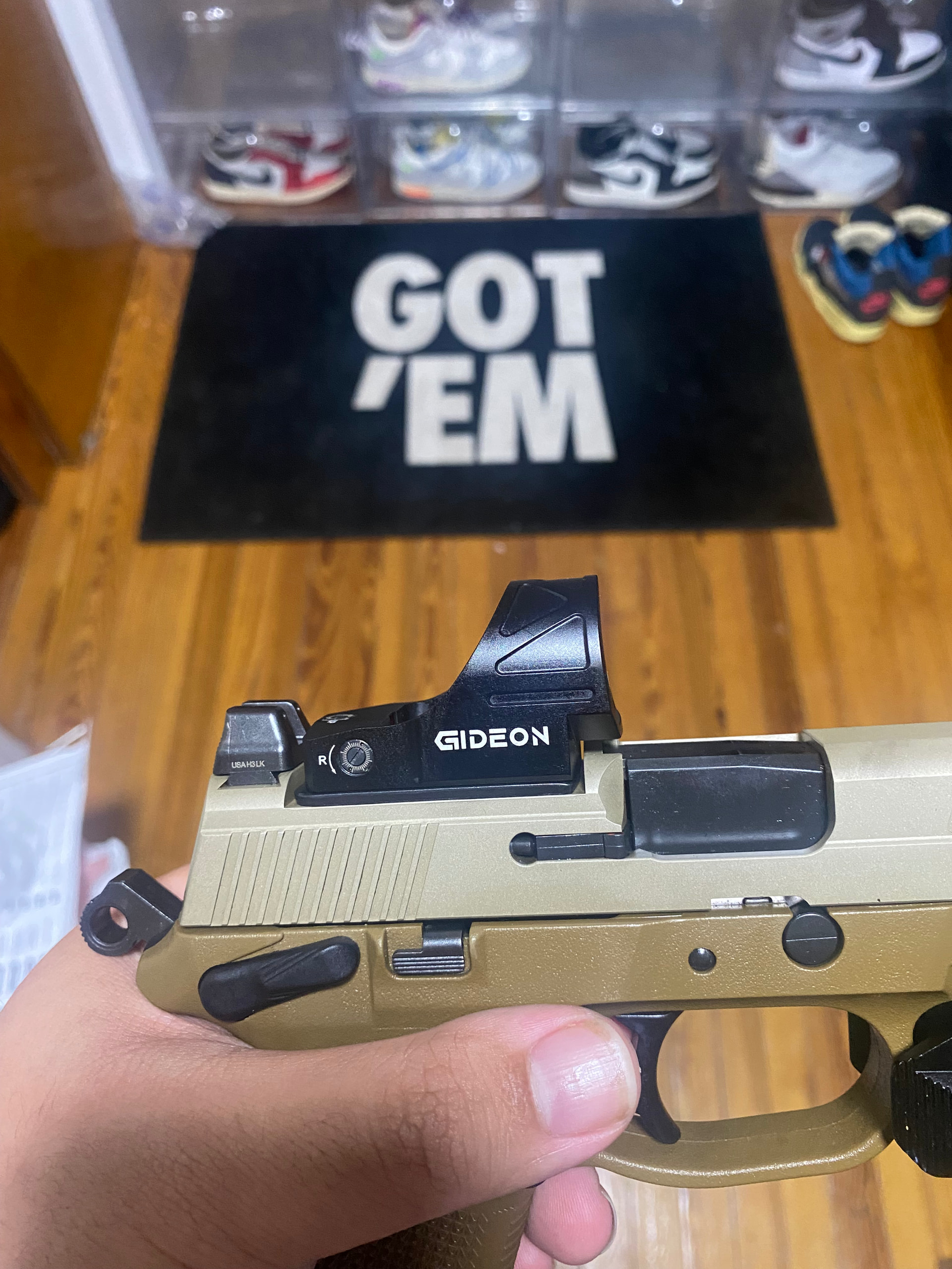

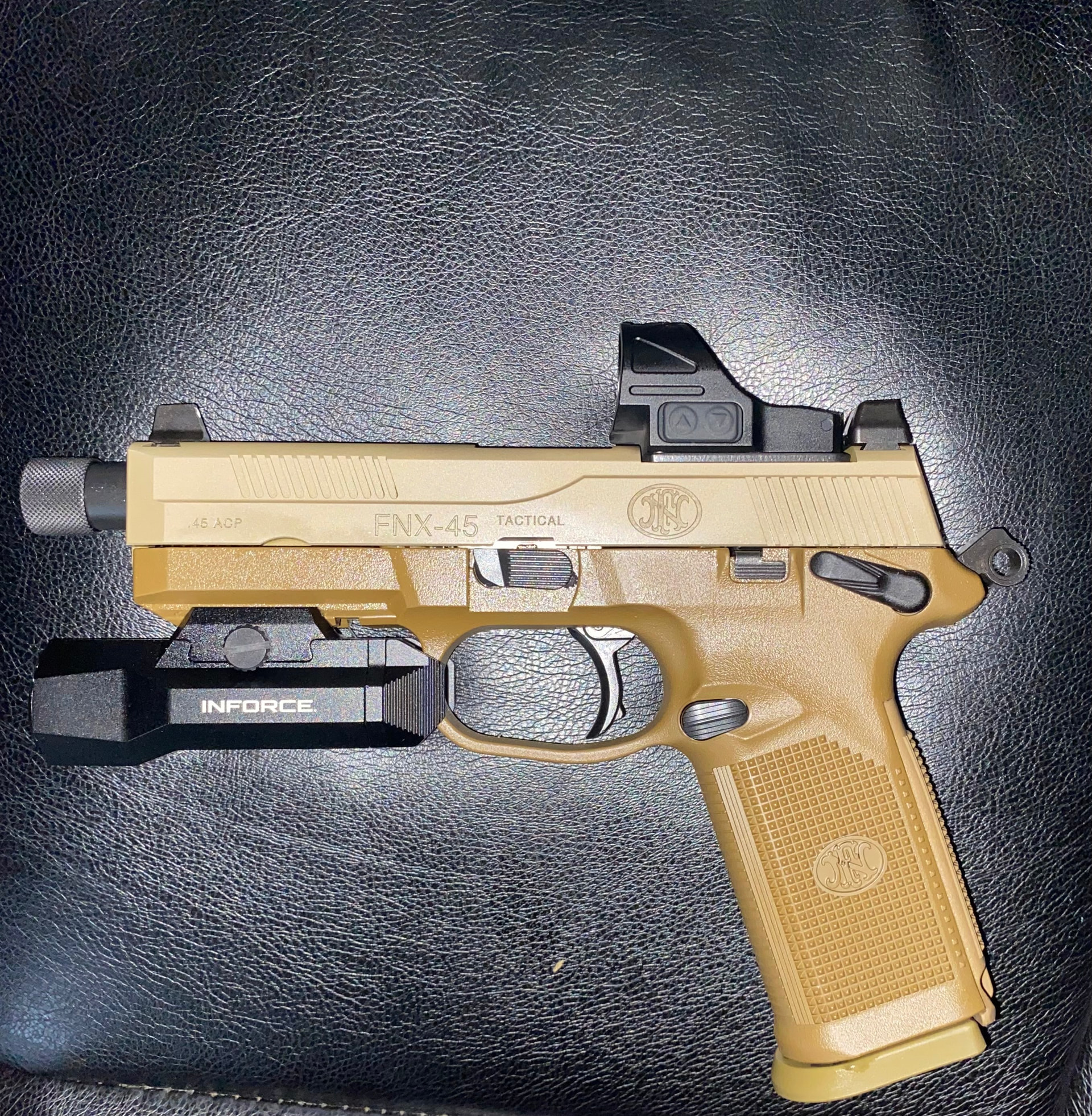

I have the Gideon Omega on my FNX 45t and I couldn’t be happier. Nice big window, so super easy to transition from target to target. I used a plate that came with the pistol to mount the red dot.

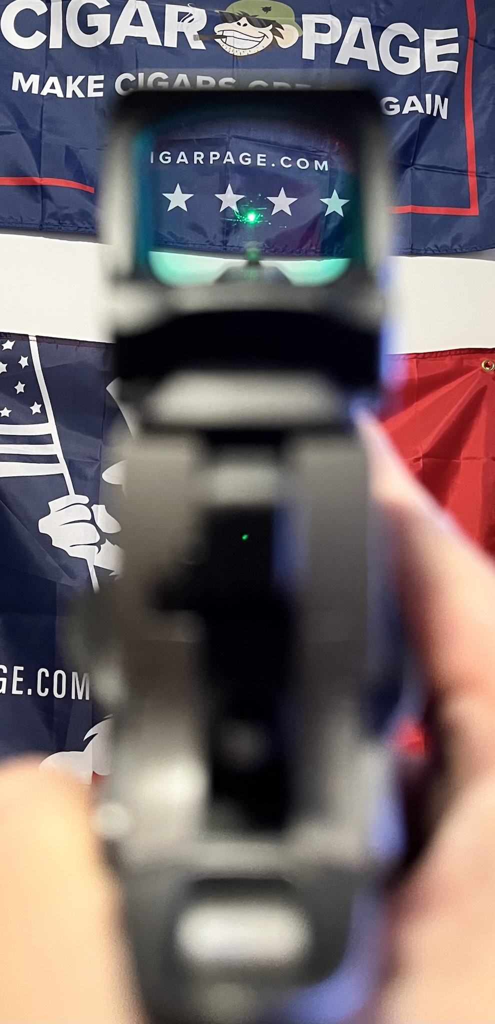

Below is just to show the dot better
