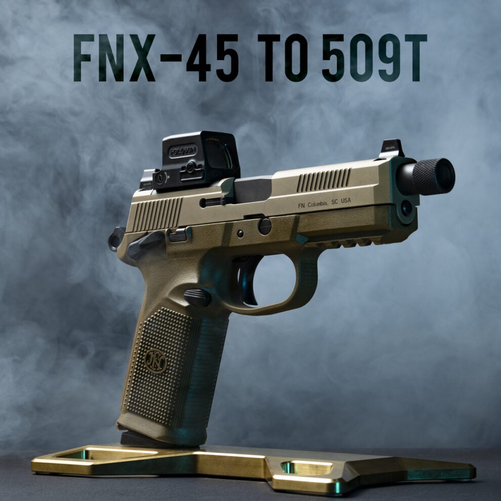

I think right now I’m settled on the 407C X3 as my primary choice and the 509T if I can bring myself to liking the look of an enclosed sight on a pistol. I’ve been using a Viper till now, so I’m kind of used to a smaller window.
Also, this will not be a competition gun, so I need to prioritize ruggedness, and the larger the glass the easier it is to break.

I decided on the 509T. Even though I hate the way enclosed optics look on a pistol, after looking at all reviews and opinions, it appears to be the more robust option. We will see what it looks like on my pistol when it comes in.
I had to order the black sight. Unfortunately, the FDE was $50 more
