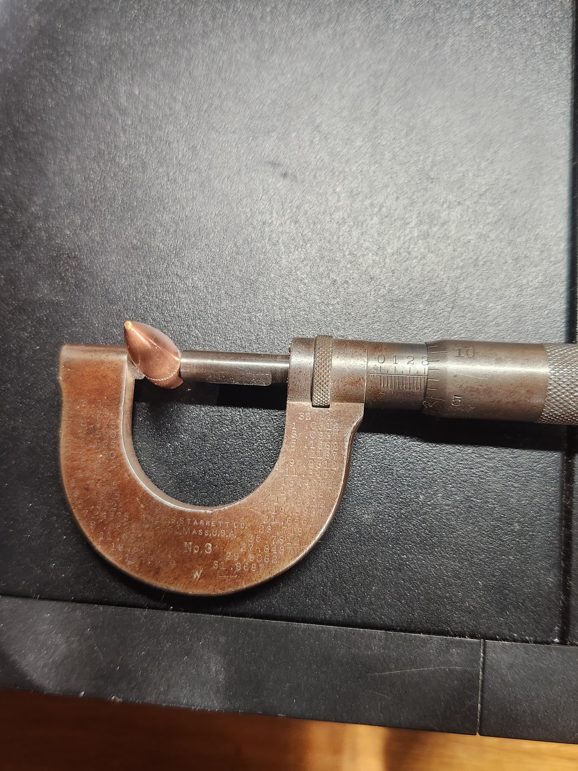

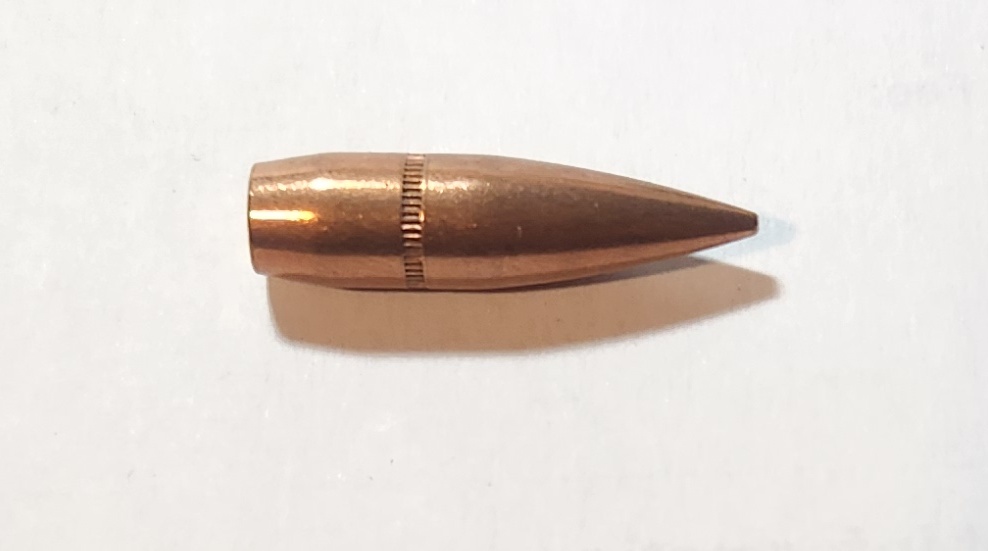

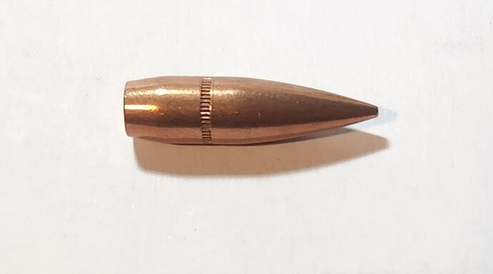

I have about 2K IMI .309 147 gr BT seeds. Those should be fine at the 300 yard range at my club, right ? I have about a dozen other assorted boxes of Sierra and Nosler .308 seeds in various weights from 100 gr to 190 gr
This is the IMI
Federal Gold Metal Match uses a 169 gr. Boat Tail Hollow Point bullet. I can put two clean holes through a quarter at 100 yards off the bench in my Remmy 700
Is this a typo? .309 does exist but usually hard cast for lever guns or in 7.62x54mmR for them commie rifles.
Assuming it’s a typo, what u have is M80 Ball freedom seeds. u can expect about 2 to 3 moa from them, and load data is not easily found. Looks like most folks are working up their own LD using modified 150gr recipes. This bullet seems finicky about seating depth too.

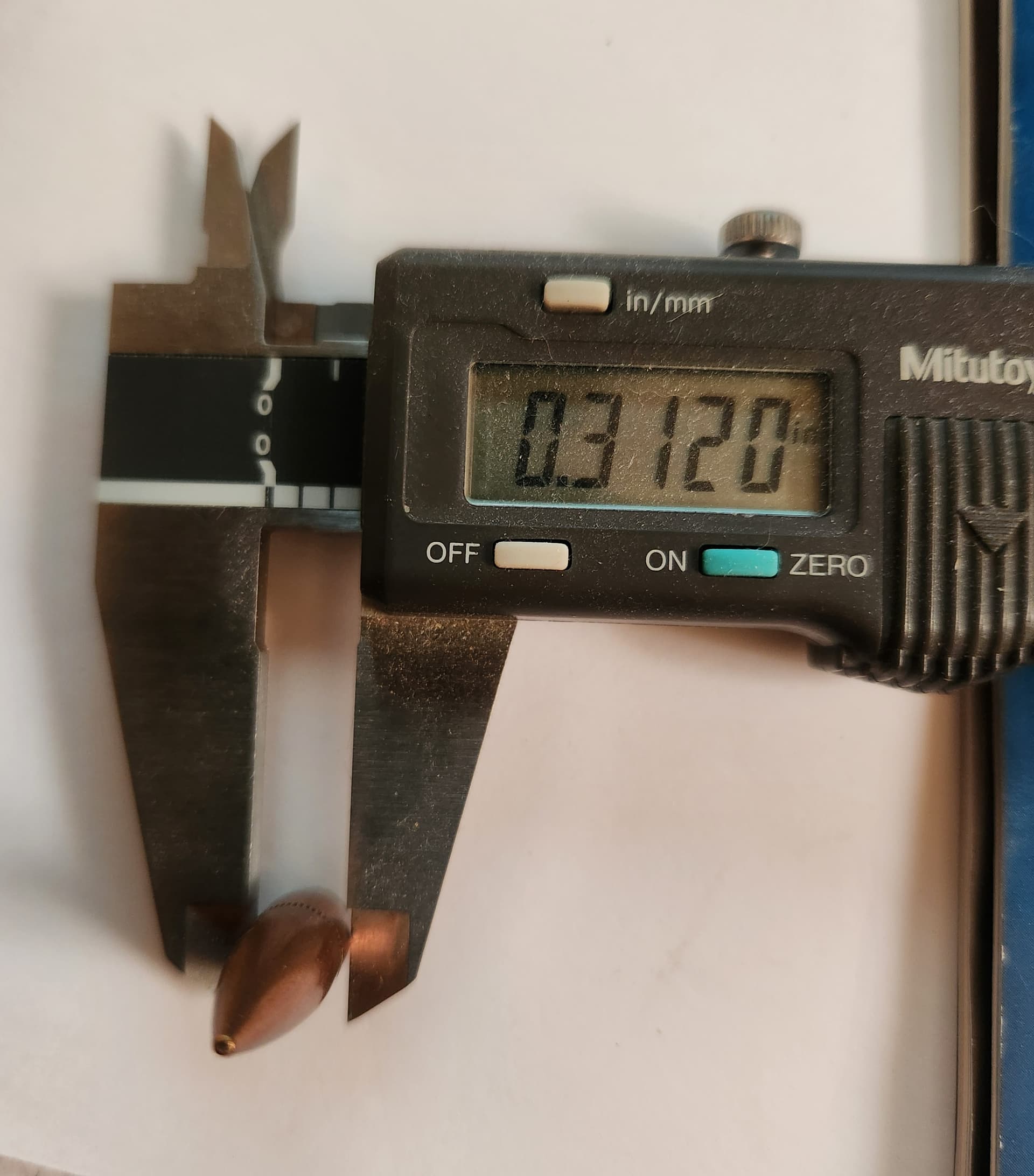

Yup, that was a mistake. They measure out at .311 (ish) - so they will go to my SKS
.312 is mosin nagant food.
Edit: You could resize them but no idea what it would do to the shape.

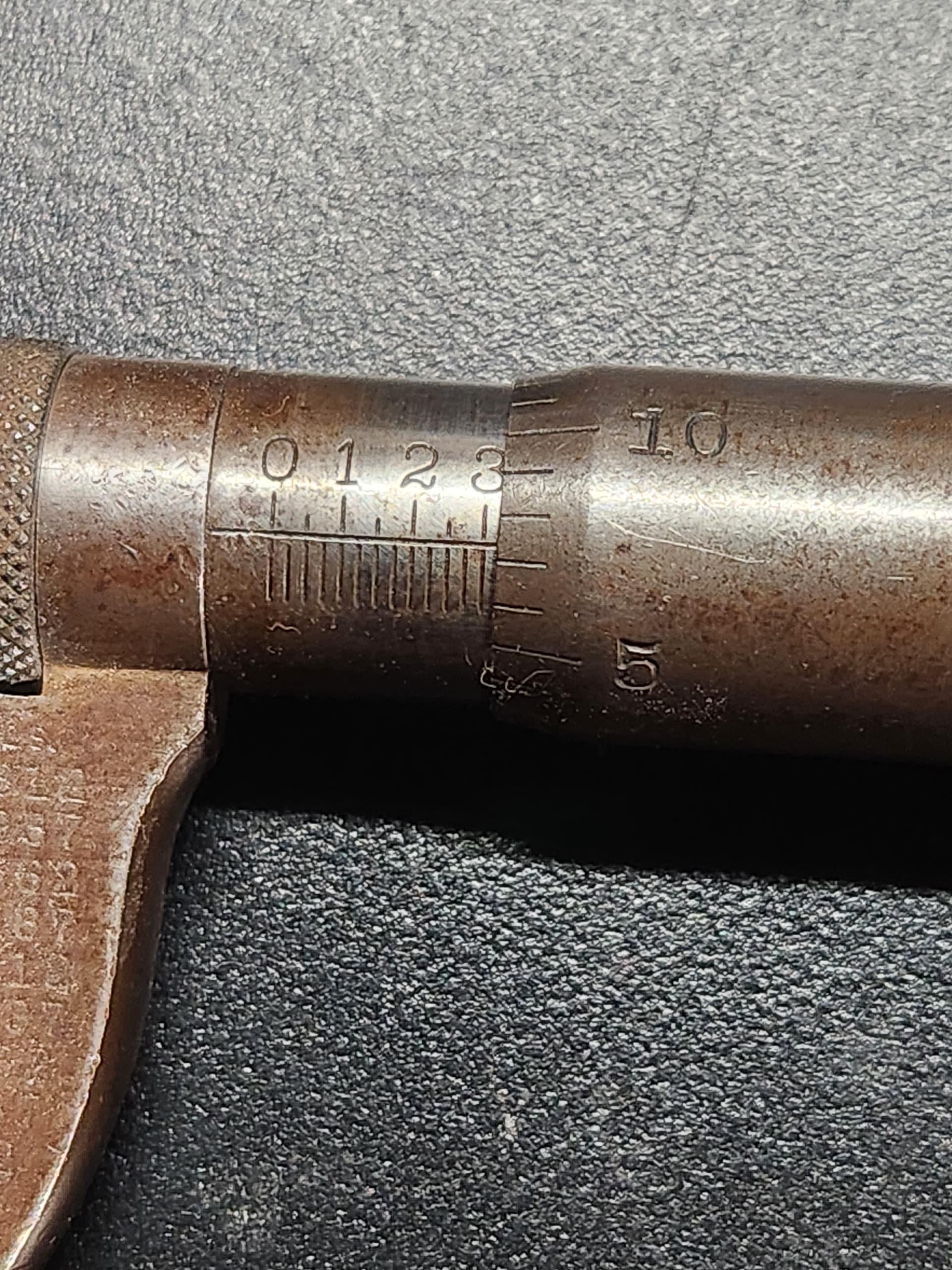

Check this out

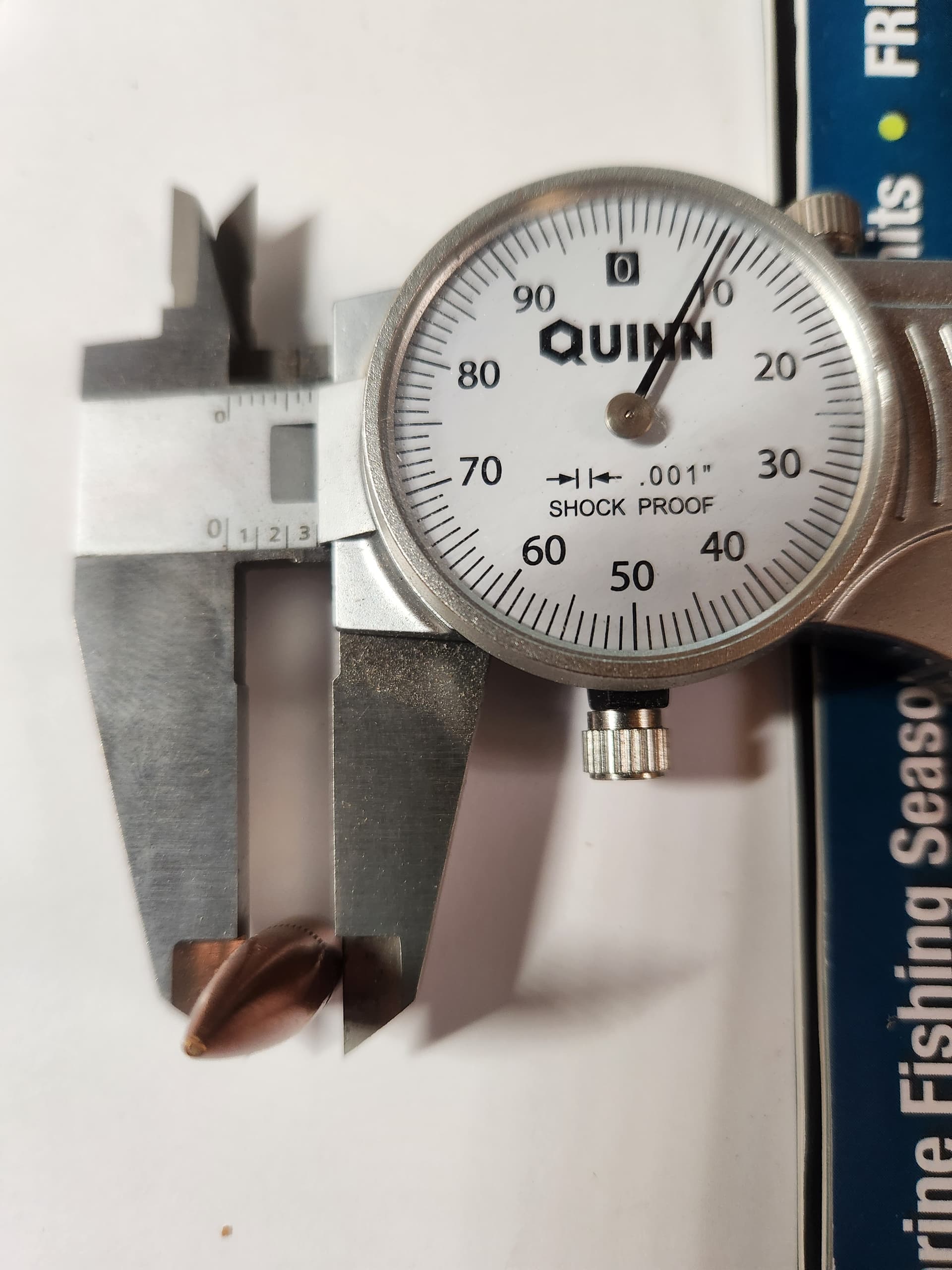

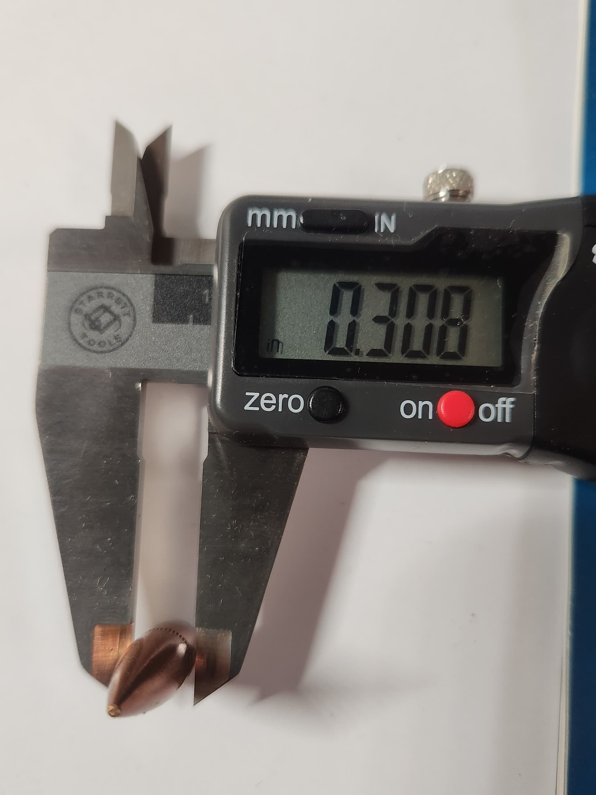

I thought this wasn’t right, went back and remeasured using 3 different types of caliper
The Mitoyo is off, they are .308
That makes things better, but not exactly simplified. There is still the dearth of 147gr load data to work around.
