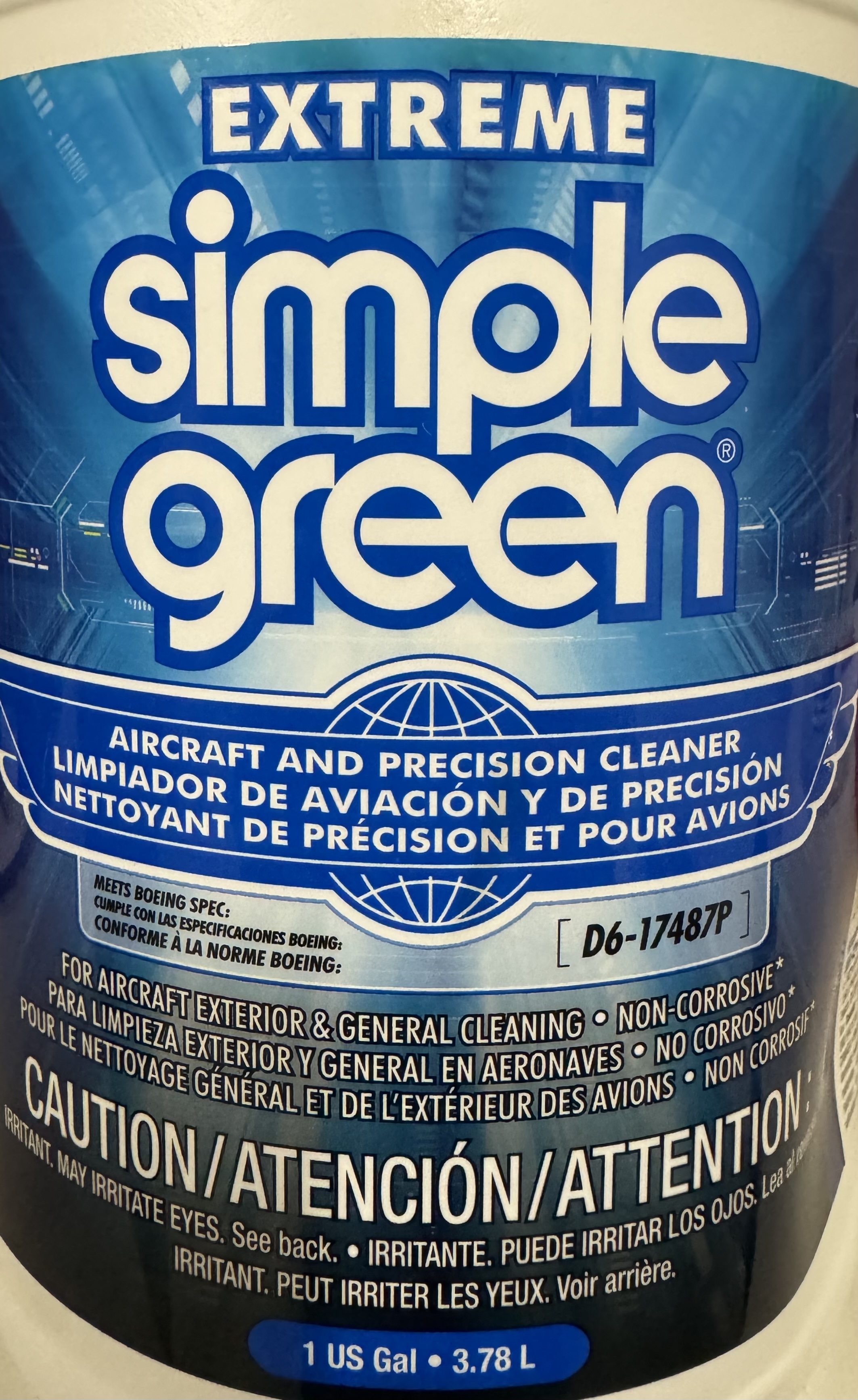

I use this. Cut 50% with distilled water.
It’s amazing how much crap will come off of a firearm you THINK is clean.
It meets Boeing’s specs, so it MUST be good!
Bonus info! Didn’t even occur to me to use distilled water. Our water is pretty hard here.

Simple green here. Diluted with water. Worked well for me.
Regular Simple Green can corrode aluminum. The Aircraft grade will not.
Good call… I don’t put aluminum in my ultrasonic.
