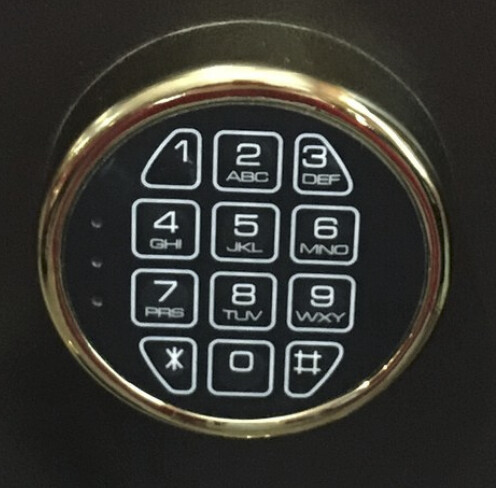

I’ve got a Stack On safe with an electronic keypad very similar to this:
Went to open it a couple of days ago and couldn’t - the keypad wasn’t accepting my code. I noticed that the yellow LED was only illuminating for a subset of the sequence of key presses needed to enter the code. Normally the yellow LED flashes with each key press.
I figured the battery must be close to dead after >5 years of service so I installed a new battery and…no change. WTH!?
I was about to get the backup physical keys but decided to research first. After a ton of searching came across this technique for “rebooting” the keypad switch. I have no idea why this works, or why it is necessary, but it resolved the problem immediately and allowed me to open the safe again.
Sharing here in case anyone else ever experiences this. Thankfully I don’t use this safe for my “quick access HD” firearms and now I never will.
1 - Remove the keypad from the safe body by depressing the plastic locking tab on the bottom of the keypad and rotating the keypad counter-clockwise
2 - Remove the battery(ies) from the keypad.
3 - Starting with the upper left corner key (number 1), press every key twice, going in order left-to-right and then continuing to the next row down. So press the keys in this order:
1 - 1 - 2 - 2 - 3 - 3 - 4 - 4 - 5 - 5 - 6 - 6 - 7 - 7 - 8 - 8 - 9 - 9 - * - * - 0 - 0 - # - #
4 - Let the keypad sit, battery still out, for at least 2 minutes
5 - Re-install battery and re-mount keypad to the safe door. It should now work with same code previously programmed.
