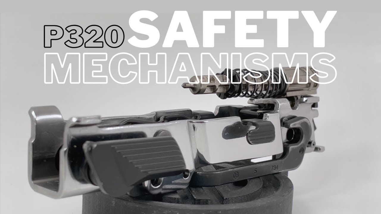

  2. The design of the drop safety plus shooter behavior. The drop safety on the 320 compare to the designs of the glock and M&P (which are very similar), is rather delicate. It’s a thin piece of stamped steel and a small spring. It NEEDS to be regularly inspected for proper function, and most people treat it like it is a forever part. One of the least talked about NDs and one of the better ones in terms of after incident analysis occurred with the US army and training. A foreign body entered the gun and seized up the fire controls. Young GI di young GI things and squeezed as hard as he could and mangled the drop safety in the process. Gun later discharged due to impact (IIRC impact from trying to clear a malfunction). But wait! some competitors have had this issue and they know what they are doing! Yeah, many don’t and jump into modifying guns they don’t understand how they work. One of the main things competitors want to modify is pretravel because it varies a bit in the 320 and ranges from a fair amount to lots and lots. Enter triggers with pre travel adjustment screws. You can take out all the pretravel! Great, but you also disabled the drop safety. For bonus points, the pre adjustment screws on some of them can work loose and become a foreign body in the gun. This can lead to the above.

So the lawsuits that have been won/settled made the argument the sear design is defective/dangerous. The sear engagement, they say, is uneven and insufficient. It’s no more uneven than anything else, and is sufficient compared to other reliable firearms. But most importantly the striker leg falling off the sear CANNOT set off a round unless the drop safety is disengaged. Anything legitimate, I suspect, is going to have to come down to a defect in implementation or design of the drop safety. Or a foreign body altering the relative geometry of the design.
The one possible exception to the sear engagement thing comes back to something I have seen recommended online several times as well as a possible revision issue. The 320 has two sear springs. Some folks have recommended using different weights at the same time. This can create issues with things moving unevenly, but it should generally function. However some folks have recommended interlacing the two springs and making basically an X out of them. Do not do this. It will greatly shorten the lifespan of the springs and increase the risk of failure taking the form of a broken spring. This impacts the sear’s return to full engagement.

Also watch the sig mechanic videos if you want to understand how your gun works.

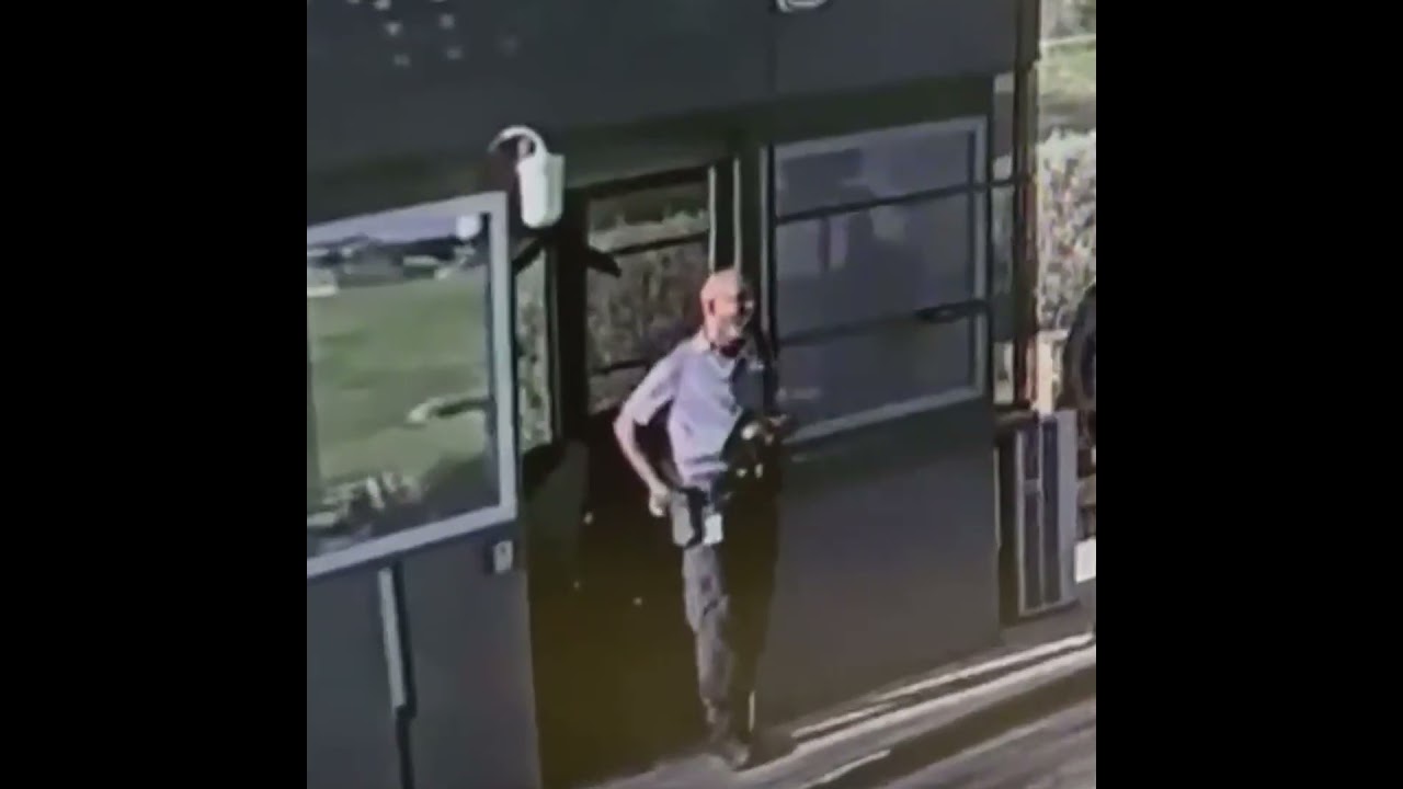

Apparently another one happened
No, This was a case where he had pressed down on the grip of his pistol. Who knows if it was a piece of leather, fabric or whatever is was that actuated the trigger. This was clearly not a case of a faulty gun!
I can’t tell anything from that footage. It is way too grainy and unfocused.
