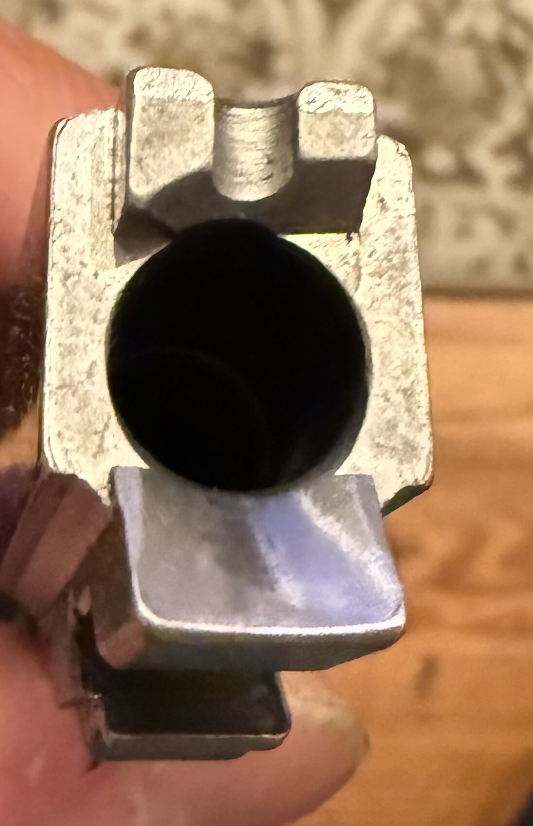

Is there a photo of the issue?
This would be helpful. Even if you can show us what the extractor is looking like.

Ok. The gun has about 4000 rounds through it 3000 with apex trigger. Trigger was put in at we shoot a couple years ago. About 3000 of the rounds were blazer fmj 115gr. I never had an issue with blazer before. I don’t have a picture of it locked. The reason I feel it may be the extractor is when I got it unlocked and the round fell. As I examined it , the was notch in the brass and scape down the case. When I go next week I’ll take a picture. I think I’m going to take the extractor out and clean it up.

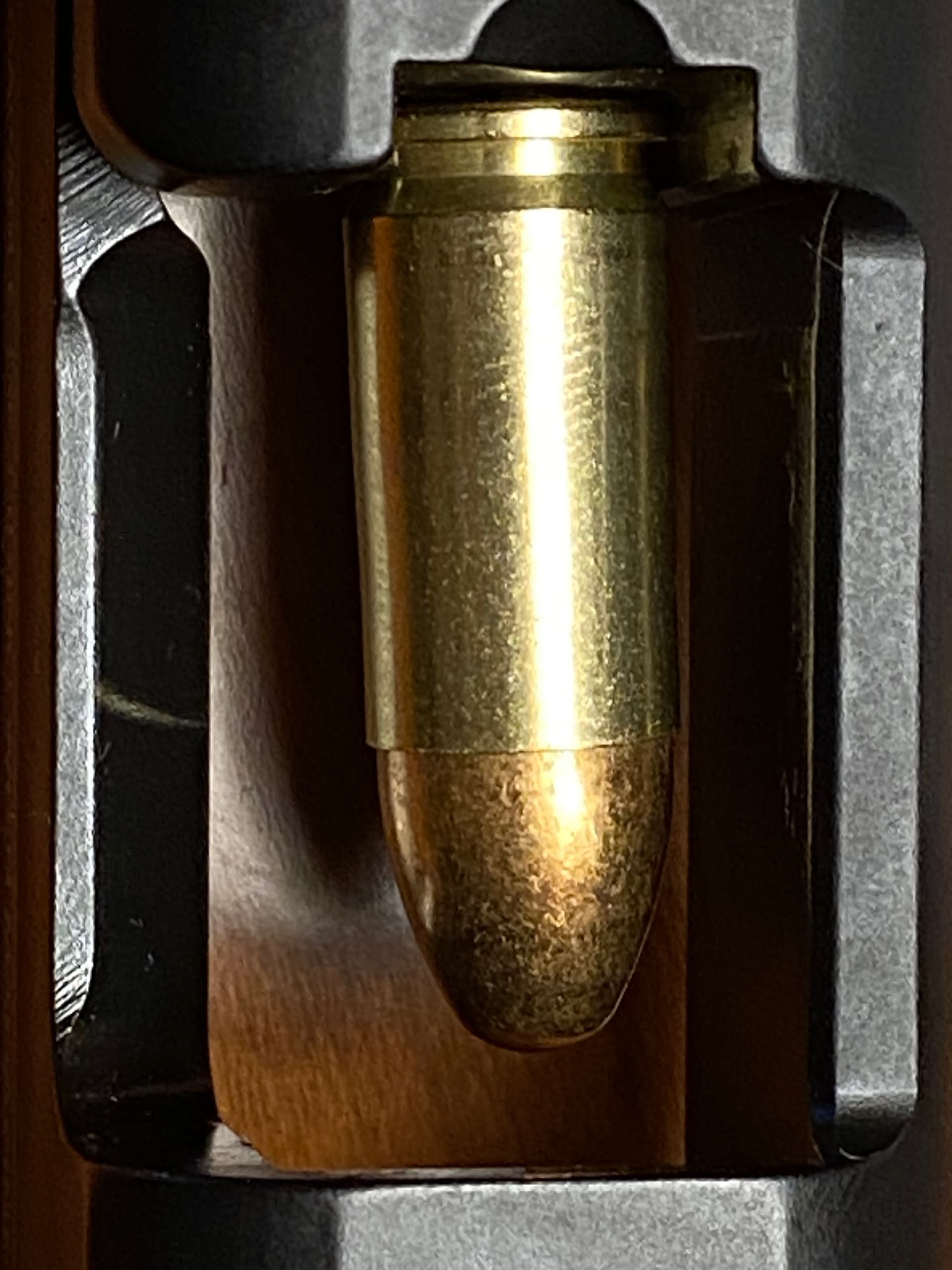

Dropping a live round seats all the way in and falls out on its own?
No obstruction in and out clean

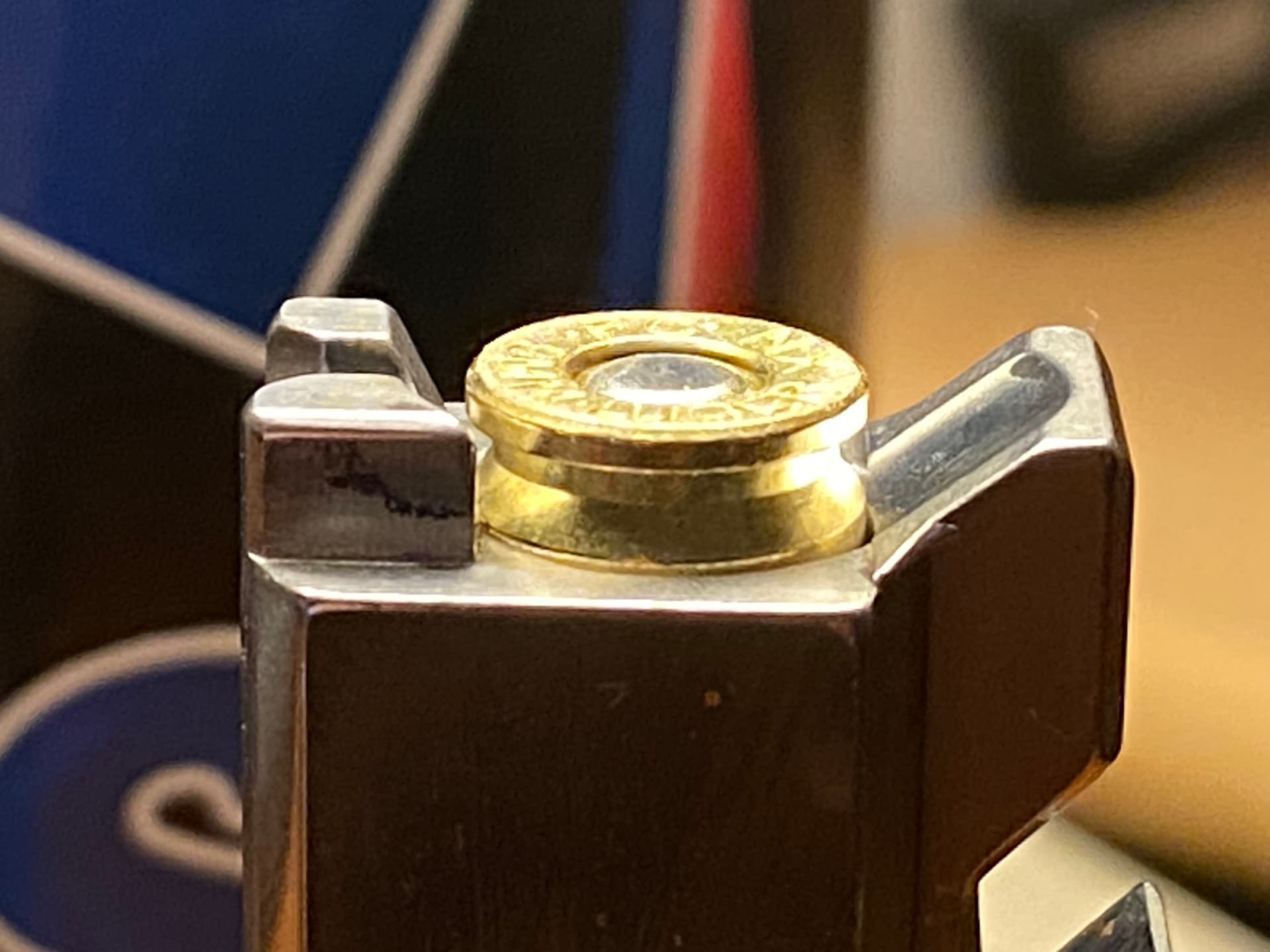

:+1: Ruled one thing out. Could also test the extractor holds a round in place:
Then you are down to recoil assembly and check rails/slide operate smoothly.
