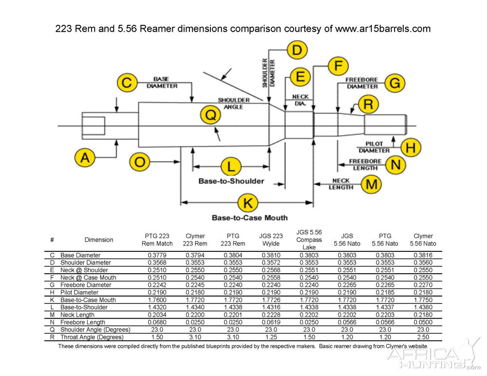

There is functionally no difference between 5.56 and .223. The cartridge is functionally the same. Will some have different thickness case walls? Yes. Will that thickness variance track to the 5.56/s.223 headstamps? No. Are the chambers different? In theory, yes. 5.56 per spec has more leade than .223, and that in theory can reduce max chamber pressure allowing for more powder to be used before kaboom. 5.56 in THEORY has more leade, but in practice, the reamers for cutting the chambers vary enough in their specified dimensions that there is significant overlap between .223 and 5.56 chambers. Add in tool wear and it varies even more. Should you not care? If your barrel was made in the last ~20 years, probably not at all. We aren’t talking about blow up your gun differences here. Be aware of signs of high pressure. If you see them consider not shooting that ammo in that gun.
