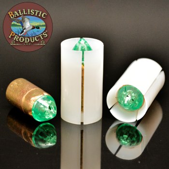

Any one load 20ga slugs
  • bullet Dimensions: .450" x 1.105" (258 grains)
  • Sabot Dimensions: .630" x 1.140" (36 grains)
  • Total Weight (bullet + sabot): 294 grains
  • Quantity: 100 slugs $69/per 100
