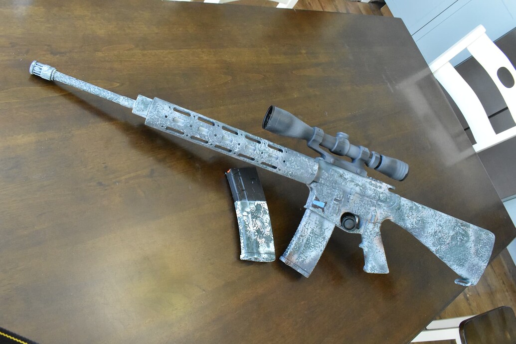

finally got the spare parts gun to the range today. Mixed results. First off, my Primary Arms red dot has developed a habit of turning itself off after every shot or two, and the adjustment for elevation got stripped. It is going into the trash, because it is garbage. I’ll just run it with the scope for now. Then there were the FtFs due to light strikes, 40% failure rate. I used a somewhat light spring kit that is apparently too light so I replaced the springs.
On a positive note, I like the balance and feel of the rifle, it is fairly light. The Carlson’s Comp worked better than I would have thought. It did a great job keeping the muzzle down without the nasty blast of a break. And, the brass ejected perfectly at 4 o’clock.

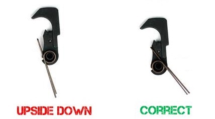

I went to MCRPC again today. Light strike issue solved. I am an idiot, installed the hammer spring upside down. No wonder the trigger pull was decent, now it is like 8# (ugh) and gritty. Maybe I’ll polish the trigger and sear, see if that helps.
