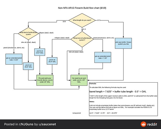

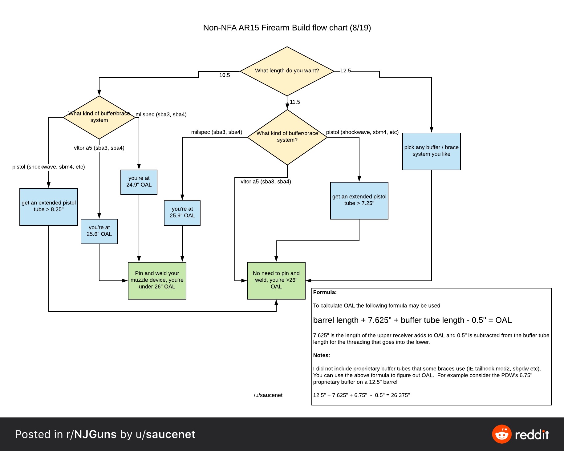

As I recall, an ‘other’ firearm must be at least 26” in length, CAN have a brace, and MUST have a VFG.
Not ‘meant’ to be fired from the shoulder.
Unless you want to pin and weld a muzzle device, I think the magic barrel length is 12.5”, but I could be misremembering.
It does NOT need to say anywhere on the weapon that it is an ‘other’ firearm.
Great, thanks!
Sounds like u building an AR-other. Yes as the other members stated 26” OAL from buffer tube to barrel, must have vertical foregrip always installed and either a pistol brace or left naked. Cannot use rifle stock then it’s construed as SBR.
The magical number is 12.5” for the barrel and then u don’t have to pin and weld flash hider or brake.
There used to a real nice flow chart out there. Too bad it hasn’t been reposted and made a sticky again.
