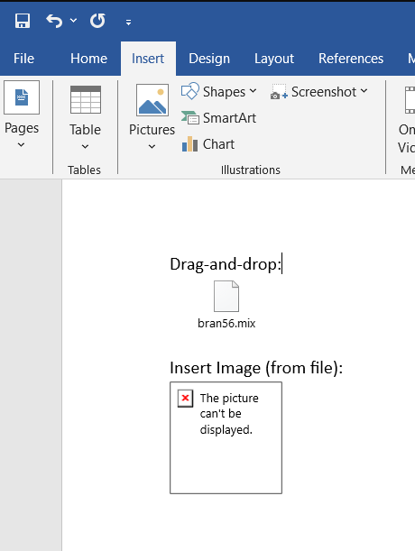

No go. Either attempting to “Insert Picture” (.mix is not one of the default file extensions it looks for, so I have to select “all” for file type) or a direct drag-and-drop into the word document both result in no image:
Bummer. If you can share a mix file I will play around and see if I can figure something.
