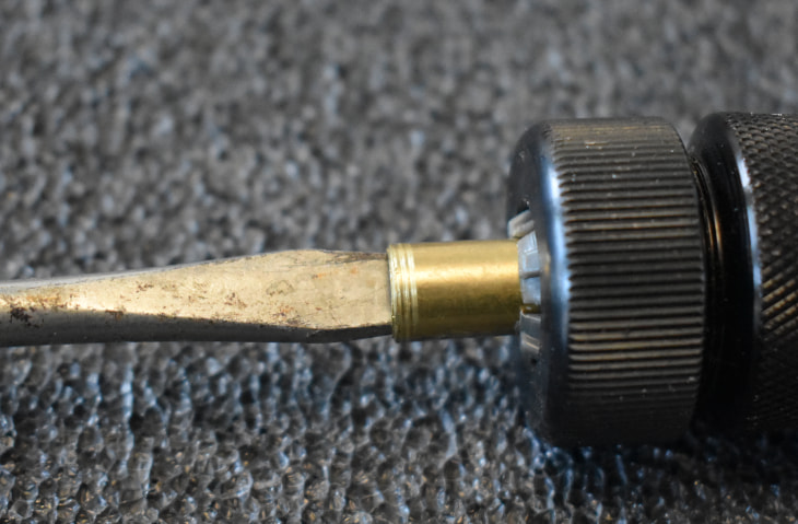

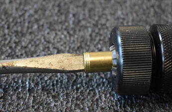

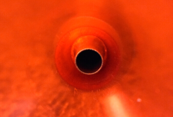

The bright idea was to neck a cartridge down to a little under the inside diameter of a resized case. Then cut off the case head and flare it out until the OD was a hair under the funnel’s ID.
It works like a charm now, but mistakes were made. They will remain largely undocumented. :roll_eyes:

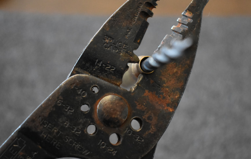

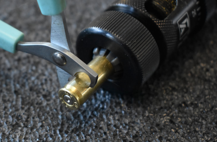

I chucked a case, rear end first, and inserted a drill bit for a mandrel. I tried regular pliers and a wrench first, didn’t do much except chew up the neck. So I dug through my rarely used tools toolbox and VIOLA, there she is. A non grippy hand tool tool with an arbor and die made just for this day.
I learned this method is known as rotary swaging. The electricians pliers could not be better suited. It cradled and captured the neck without it jumping out of the notch. It took several passes but it worked like a charm.

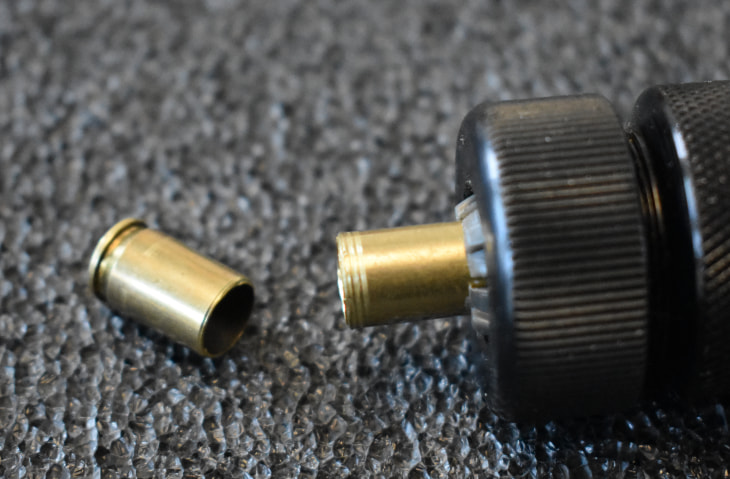

Now, to cut the case head off. Well, all I’m going to say is this. It is not my fault the Frankford Arsenal universal case trimmer looks a LOT like a lathe chuck. Some of you may recognized the advanced cutting tool I used.
Now for a precision flange with another precision tool.

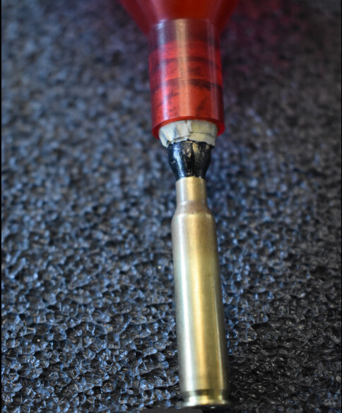

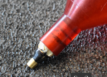

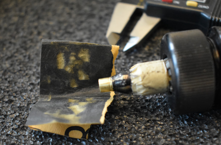

Wrapped some masking tape around the case body until it fit snugly in the Lee funnel, then trimmed off a bit for a flush fit. Deburred with 800 grit sandpaper.
Now the funnel adapter fits like a glove, no more spillage.
