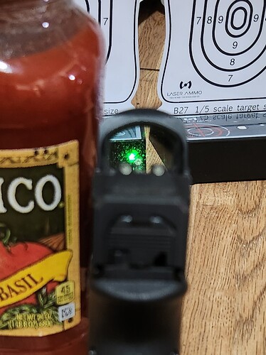

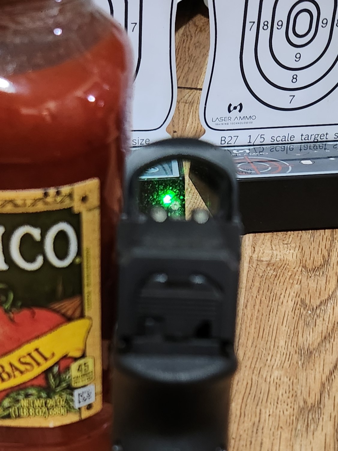

anyway…my holosun green dot. i think i just screwed it up. was gonna do some dryfire. window glass was dusty/dirty. used a “lens cleaning” brush, then tried a lens wipe(those ones you can buy at wallyworld for your eyeglasses). got the lens looking clean, but what you see in the picture is what i see when looking through it. in brighter light, it’s not too bad…in low light(like in a room) it’s horrible. is this fixable? or did i just destroy my dot? there are also a couple of visible scratches on the lens that don’t show in this picture. i guess for the most part it would be ok in a self defense scenario…but not really sure. i’d rather not have to change it out…but i might’ve forced it on myself outta shear stupidity. or carelessness. or recklessness. or some combination of those.
it is just needs more cleaning. if any residue is left behind it will F up the dot. make sure the emitter hole is clear if it os open.
I would try a soft damp cloth like you use to clean a I pad and wipe it with a microfiber towel
Maybe skip the wipes, seems like they left some wax or something. I would use high end glass cleaner, from a spray can. Chemical Guys makes one, you can find it at Advance Auto or another auto store. Just spray some on the rag.

sometimes i’m just too dam stupid for my own good, lolol. scorpio nailed it. there wasn’t much residue on the glass…but i had neglected to clean the opening where the thing shines through to the glass. i cleaned that, and whammo! second hand brand new.
