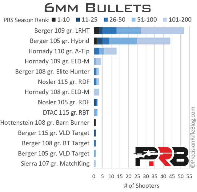

Precision Rifle Blog covered this in an article.
Top PRS shooters are using Berger OTM’s and Hornady A-Tip or ELD-M… so, pretty much whatever works for you ![]()
