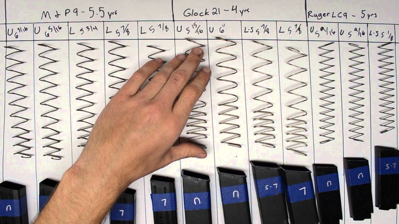

Found this through some initial searching, haven’t watched it in its entirety yet:

That was interesting as well as many of the comments under the video. It seems that the springs actually lose some length being compressed over time, and many reported feed issues years later from stored mags. But this seems to be after many years, not just a few.
