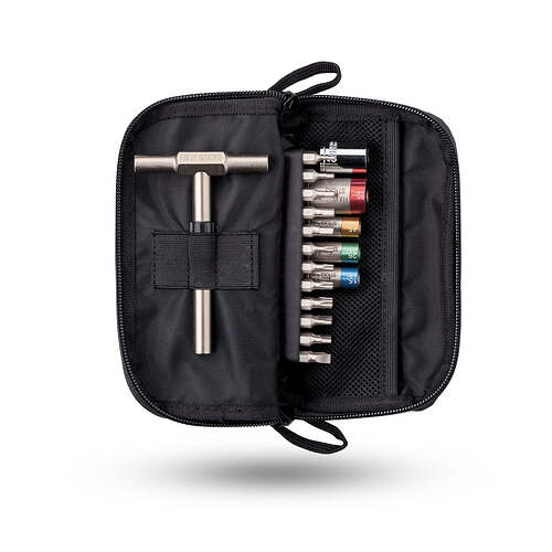

Take a look at Fix-It sticks. You should be able to put together a small kit of torque limiters together that won’t take up much room at all. I have a small kit for my range bags that covers everything I need from quick change barrel torque, to scope mounts, and rings all the way down to a 4 inch lbs limiter for the turret caps.
This kit may be more than you need, but you could “choose your own adventure” and build a custom kit by picking what you need
Fix it Sticks are excellent for the range bag but unless you’re carrying the exact torque limiter needed, the one-size-fits-all torque limiter is best for a field estimate and should be validated with a proper tool.
The fixed value torque limiters are pretty decent however.
Yeah …I tried their “all in one” torque limiter but never felt confident that I was hitting the value that I wanted - that’s when I switched and built a small kit of specific limiters. The “all in one” limiter is a great idea but I definitely prefer the specific torque pieces.
