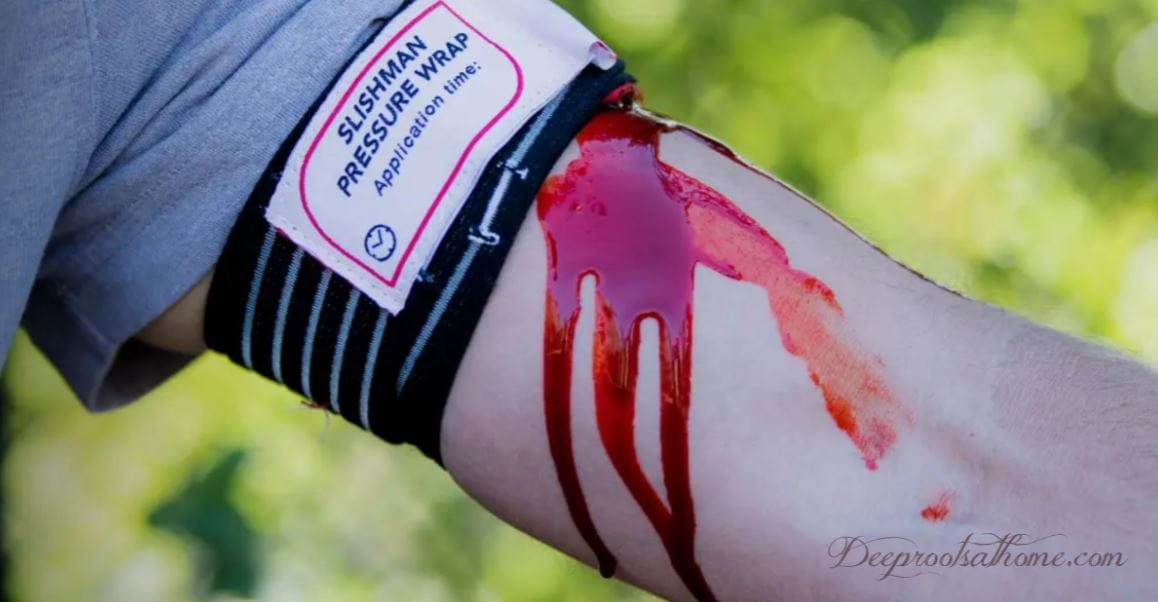

Thought this was a good article:
A replacement for the CAT tourniquet?
Depends on the application.
If you need finely adjusted pressure for a less than major bleed, or pediatric use, maybe.
If you need to stop major artery hemorrhaging RIGHT NOW or else the person will bleed to death, no.

Feature CAT Tourniquet Slishman Pressure Wrap
Primary design Arterial tourniquet Compression wrap
Reliability for arterial bleed Very high Moderate–variable
Works on large thighs Yes Sometimes difficult
One-hand self-application Excellent Variable
Multi-use No Yes

From what I remember, always pack with hemostatic gauze and direct pressure first, like the slishman. If bleeding slows your good. If it continues to bleed heavy then tourniquet. If its a severed limb injury I’m always going with the CAT.
The cool thing about the Slishman is it has multiple uses and can replace a lot of kit: sling, splint, ace bandage, head injury wrap and possibly direct pressure around the torso. Depending how big you are.:laughing:
