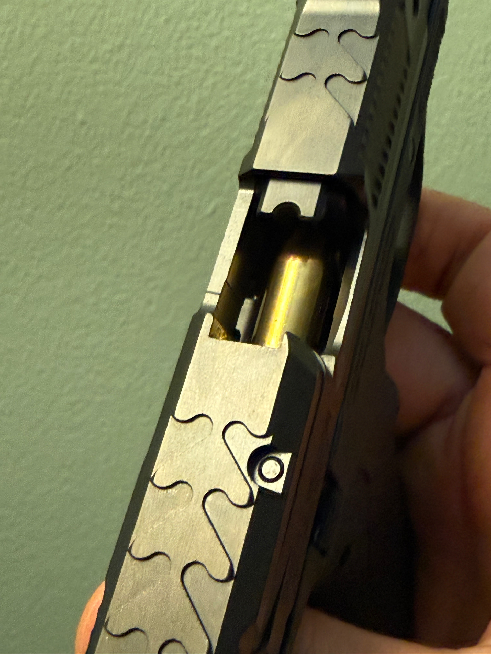

Picture isn’t clear, but this is what’s happening..
I cant tell anything from the pic. Hollow point is expensive for range ammo but it’s not mistake to shoot it, especially if you are counting on it for HD/SD.
Clean the gun thoroughly, and try an ammo that you know cycles well, a known quantity, then try the Fiocchi again.
