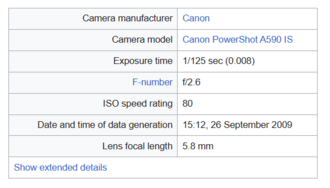

Can also be solved by looking at EXIF data that’s embedded in the image with some kind of application, but usually not just with directory viewing alone:

In File Explorer, switch to Details view, right-click the column header row, choose ‘more’ and check on ‘Date Taken’:
Regardless of the Date Modified, the ‘Date Taken’ should remain and can be sorted/searched.
*Edit: This only works on actual photo files that have EXIF data embedded so will not work on screenshots/downloaded images.
