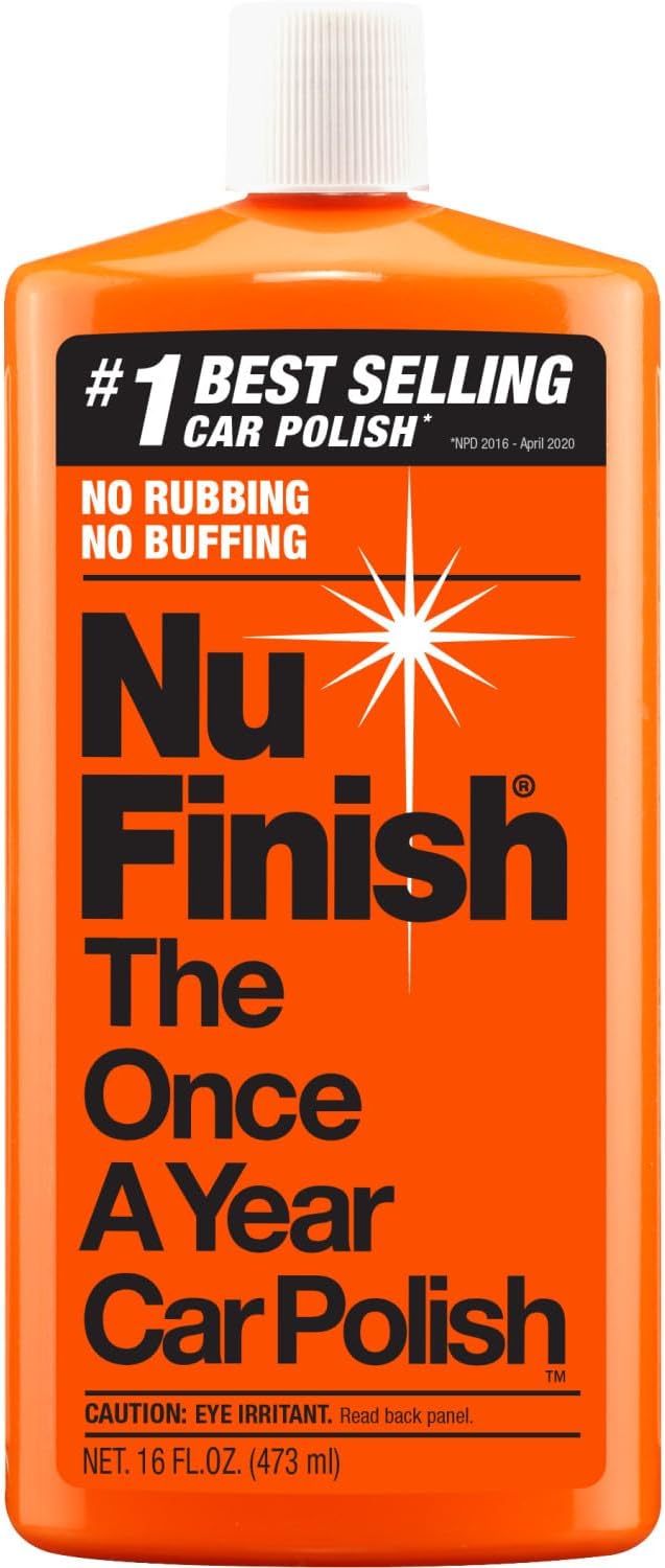

I don’t reload however I tumble the brass I use or my projects with media and NU finish,
This is what some reloads use to get clean bright brass. it only takes a couple of drops.
Trying to avoid using liquid polish as it sometimes leaves a residue that can contaminate powder. I have read a couple stories where experienced reloaders suspected that polish residue was responsible for squibs.
I’ve used NuFinsh in my corn cob media for the past 20 years. Never had a squib in over50k rounds. Just a teaspoon is all I use. Brass is clean and smooth with zero residue.
Ive used a touch of Brasso in corn cob media for years. Never a problem.
