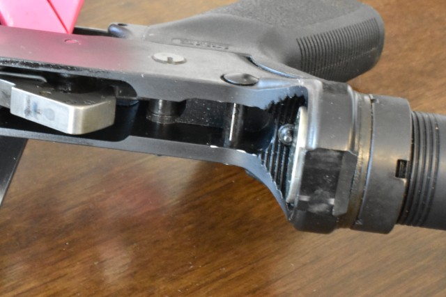

There are all kinds of doohickeys to reduce slop but this is the simplest, cheapest and most effective method you will ever see. Do this and your receivers will lock up tighter than a clam at low tide.

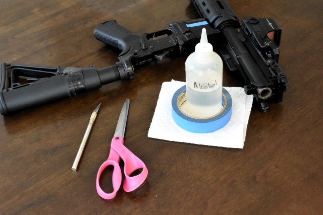

You can eliminate the slop from any receiver for about 2 cents. I did this first with my precision SPR on a lark, and it worked out spectacularly. It helped tightened up my groups to .3 MOA. You will need an X-acto knife, scissors, and about 1.5" of blue painters tape.
Clean up the surface, remove all oil and solvents with alcohol, or whatever. Just make sure it is clean.

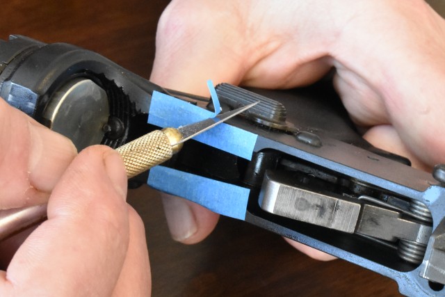

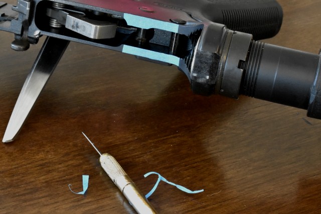

Lay two (2) strips of tape on each side of the cleaned surfaces and CAREFULLY trim.
This is what it should look like.
