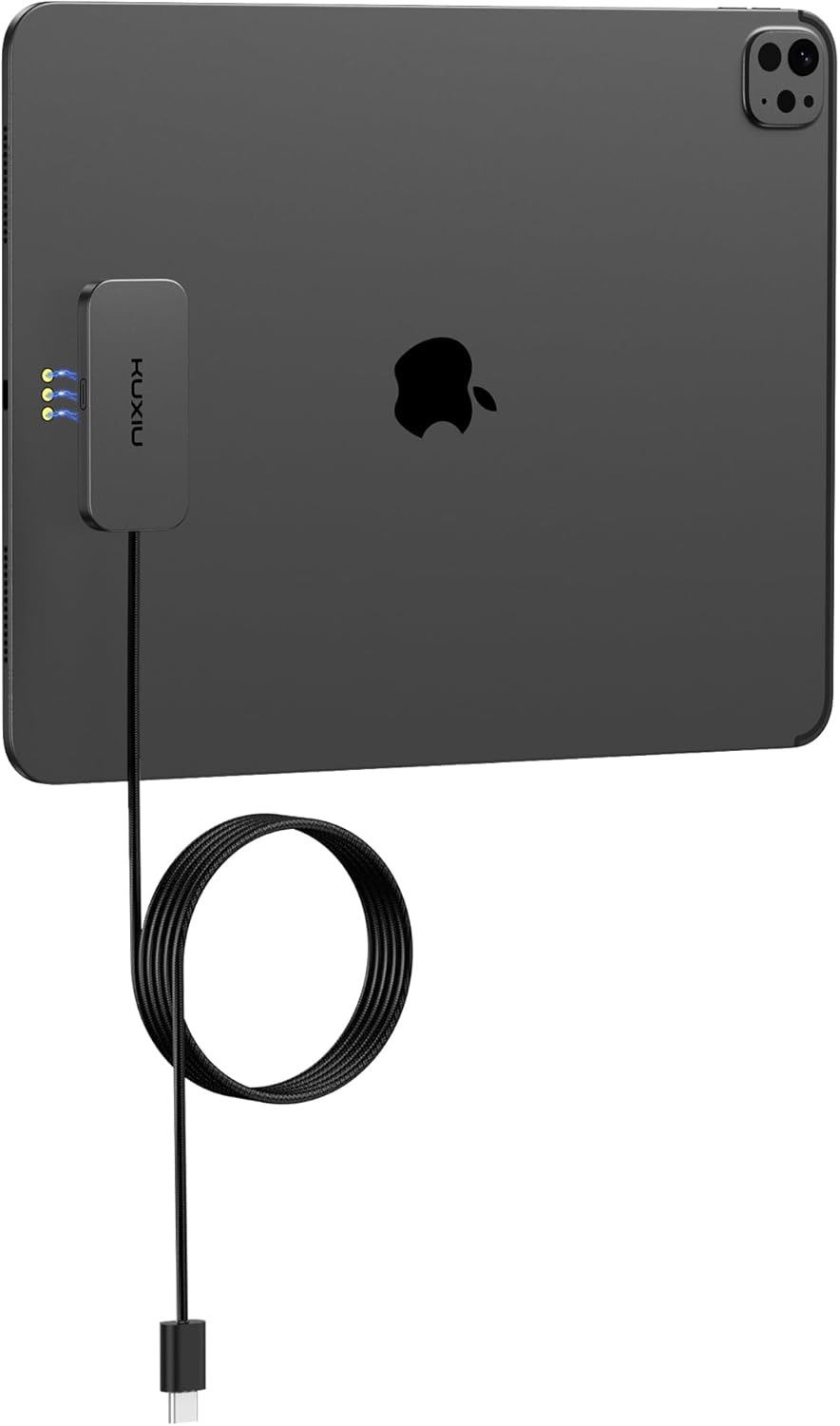

Think I just found the solution:
The iPad does have these 3 contacts on the back case.

Got the stupid “external” charger on order, hopefully that’s enough of a fix.

I’m interested to know if the induction charging works.
Nope. And believe me, between myself, Apple store and the independent repair place there was PLENTY of wiggling attempted.
Inductive charger should show up tomorrow.
Inductive charger arrived, it works. iPad charging and turned on for the first time in months.
