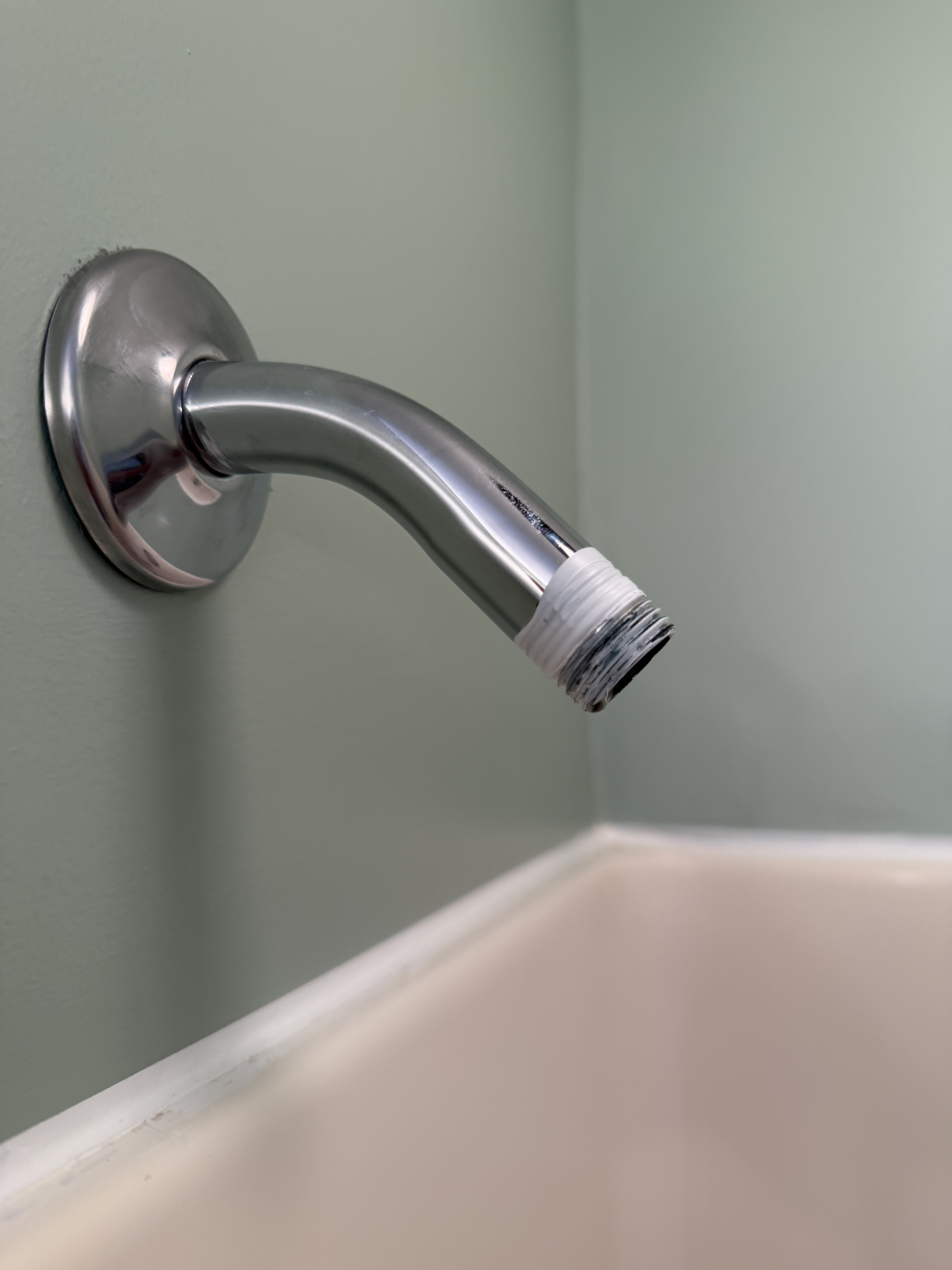

Shower outlet pipe:

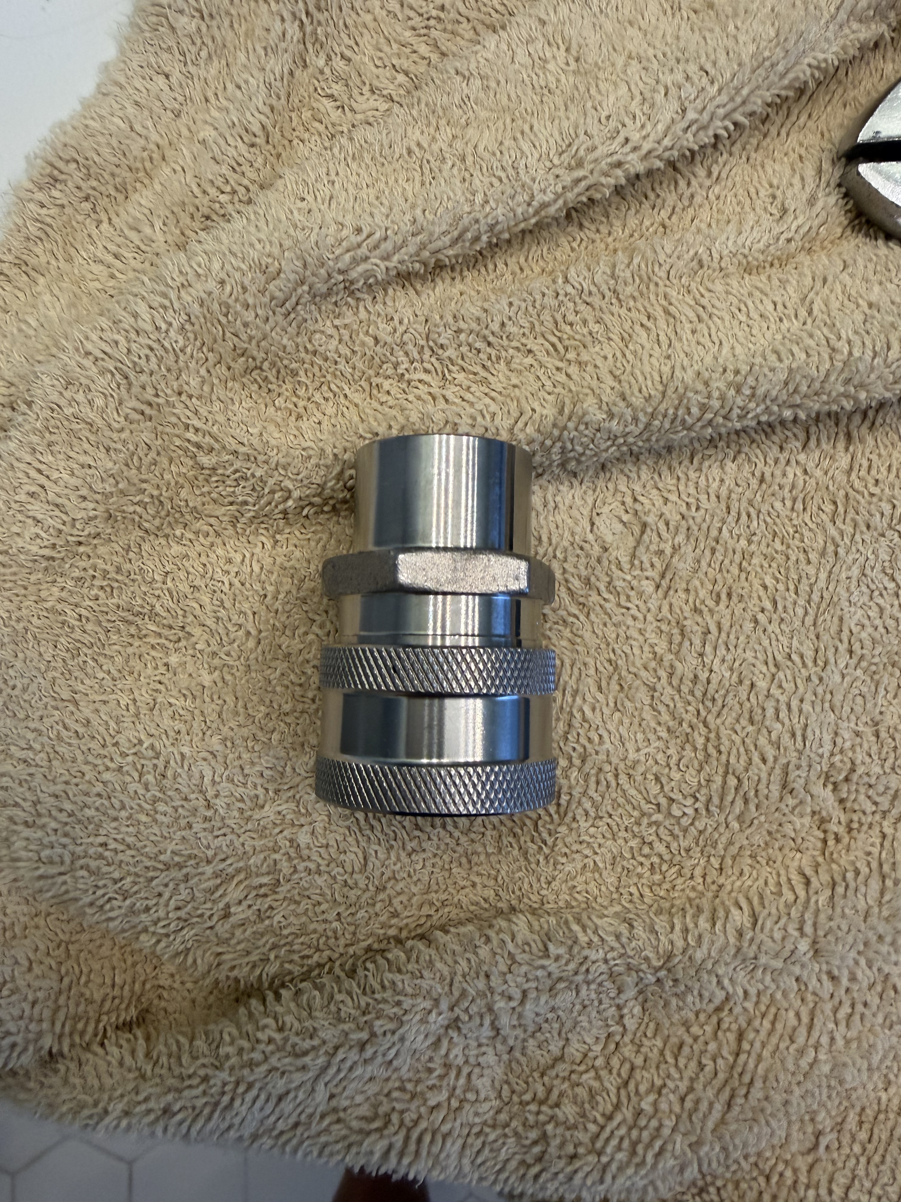

Top of the QD (shower pipe part):

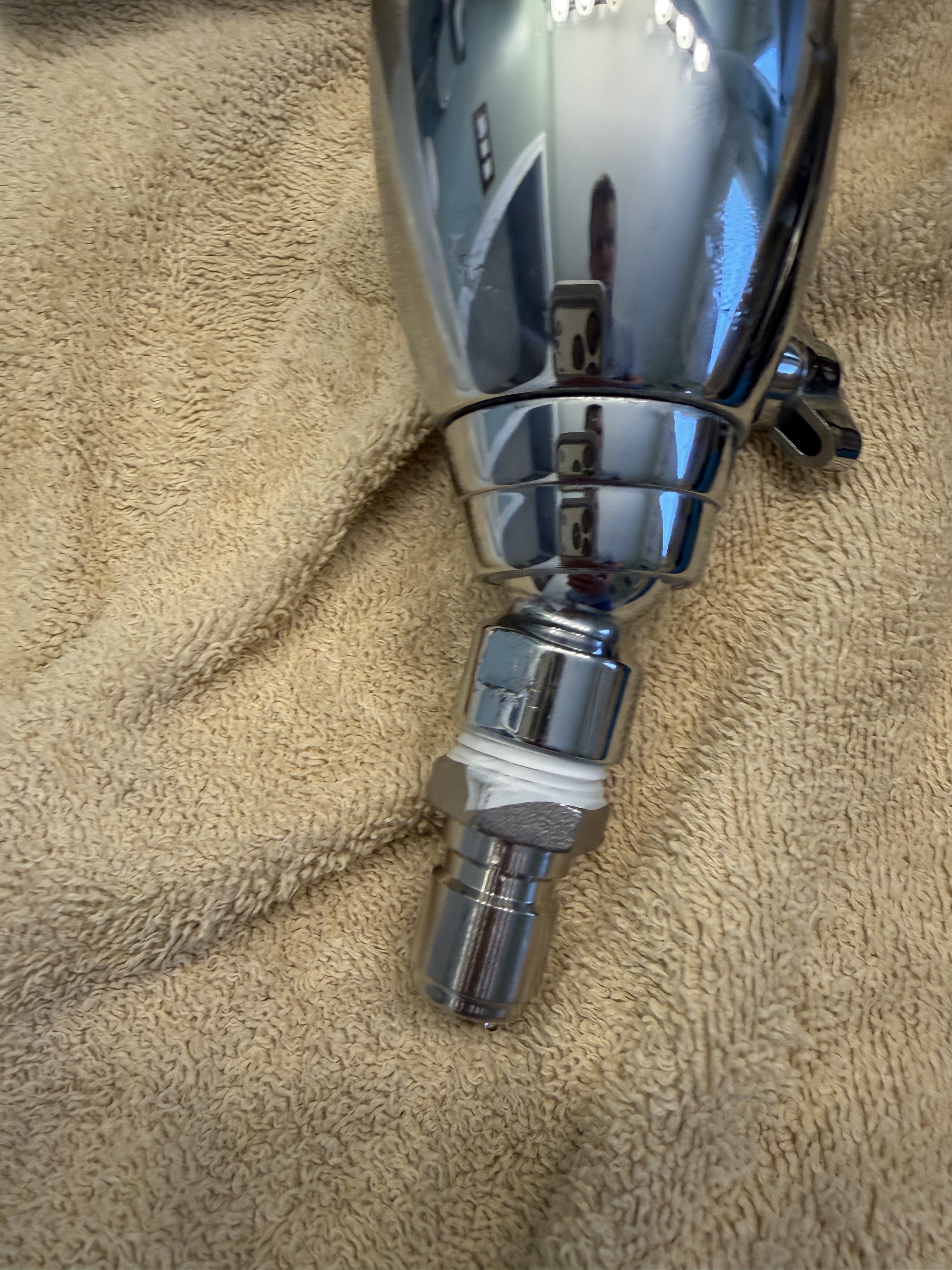

QD bottom with shower head:

Strange. One of those rubber gaskets should fit inside the female end of the QD, then seal up on the end of the shower pipe, when you screw it on. Unless the layers of existing teflon won’t let it screw down enough…

And it looks like the existing teflon starts half way up. Try taking all the old teflon off first, then see if it screws on further, with two washers inside. If it screws on half way, there’s no reason it shouldn’t bottom out on the washers.

Success! The threads had more gunk than I realized but I scraped that all out. I doubled up the gaskets, added some new tape, lathered on the dope and it’s good to go!
