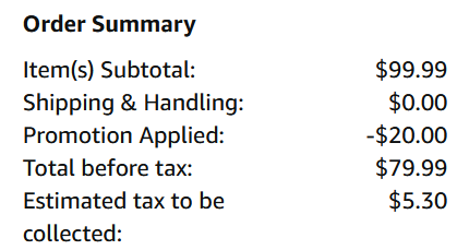

Use discount code
MONSTRUMBOP
to get it for $79.99 base price:
I ordered it this weekend, should come in today.

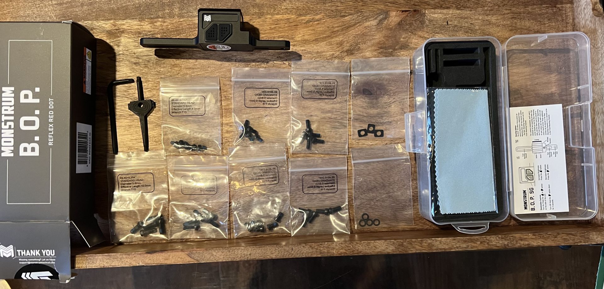

They sure didn’t hold back on the fasteners included:
What, no duct tape? :face_with_tongue:

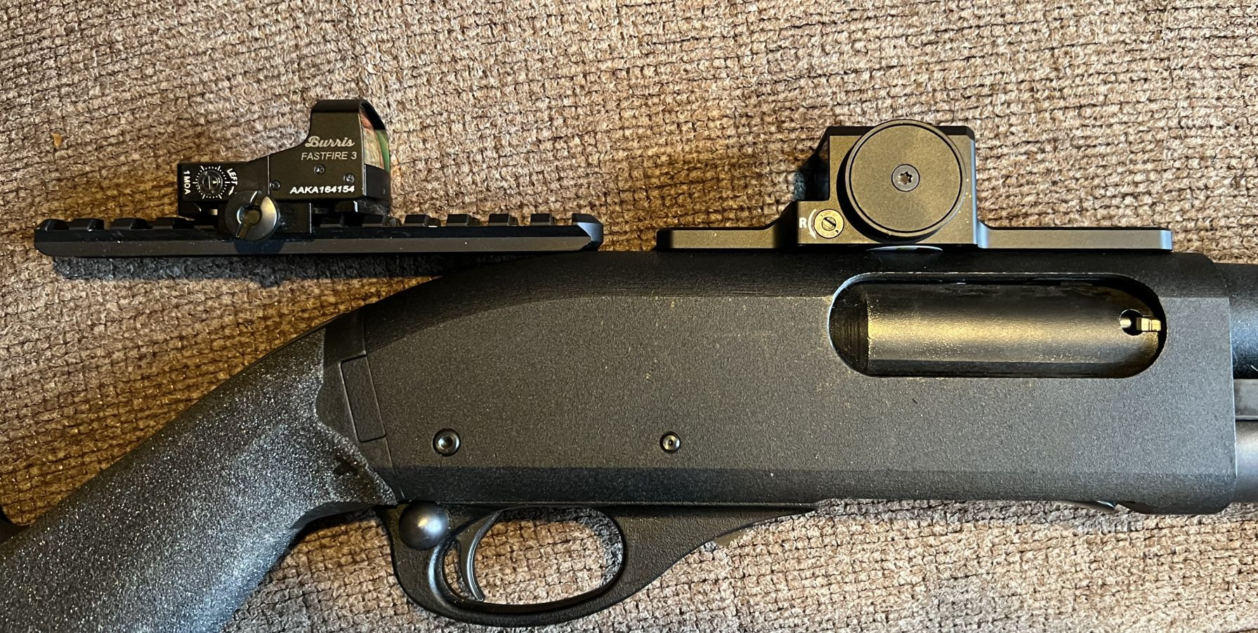

Mounted to 870, no actual range time with it yet.
Replaced what I had before - a picatinny base and Burris Fastfire 3 optic.
Quick attachment to the pre-existing receiver top screw holes that were already in the 870 receiver.

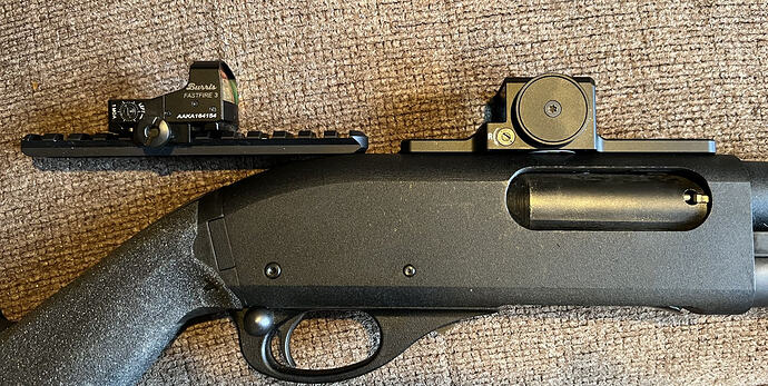

Pros/Cons so far:
Pros:
Reduced height-over-bore. Not sure exactly how much it’s reduced but the viewing glass/dot is much closer to the barrel now.
Reduced overall height - This is 1/4” shorter overall than the previous setup.
Bigger buttons - the side buttons are MUCH bigger than the tiny rubber dot on the fastfire.
Less projections sticking out to side - fastfire had a big mounting bolt that would snag, appreciate the much narrower and uniform case on this.
One piece - don’t have to worry about optic coming loose from the base.
Enclosed laser emitter - laser emitter is inside the housing, no chance of it getting obscured with dirt.
Cons:
3 receiver mounting screws instead of 4 on 870 - One of the receiver screw holes is covered by the optic.

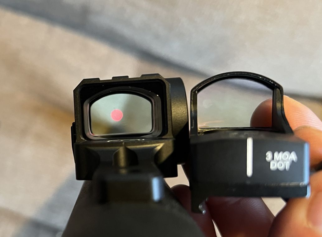

Reduced view area - estimate the viewing glass on this is ~1/8” shorter than the Burris, but it’s also just slightly wider. Image above doesn’t accurately capture the viewing area differences.
Blue tint to glass - It is very slight, but it’s there. Especially noticeable when looking against light colored objects/backgrounds.
Typical laser-projected red dot optical distortions due to eyesight - If your eyes don’t like other laser-projected red dots because you see distortions/”starbursts” in the dots then you’re going to have the same issue with this one.
