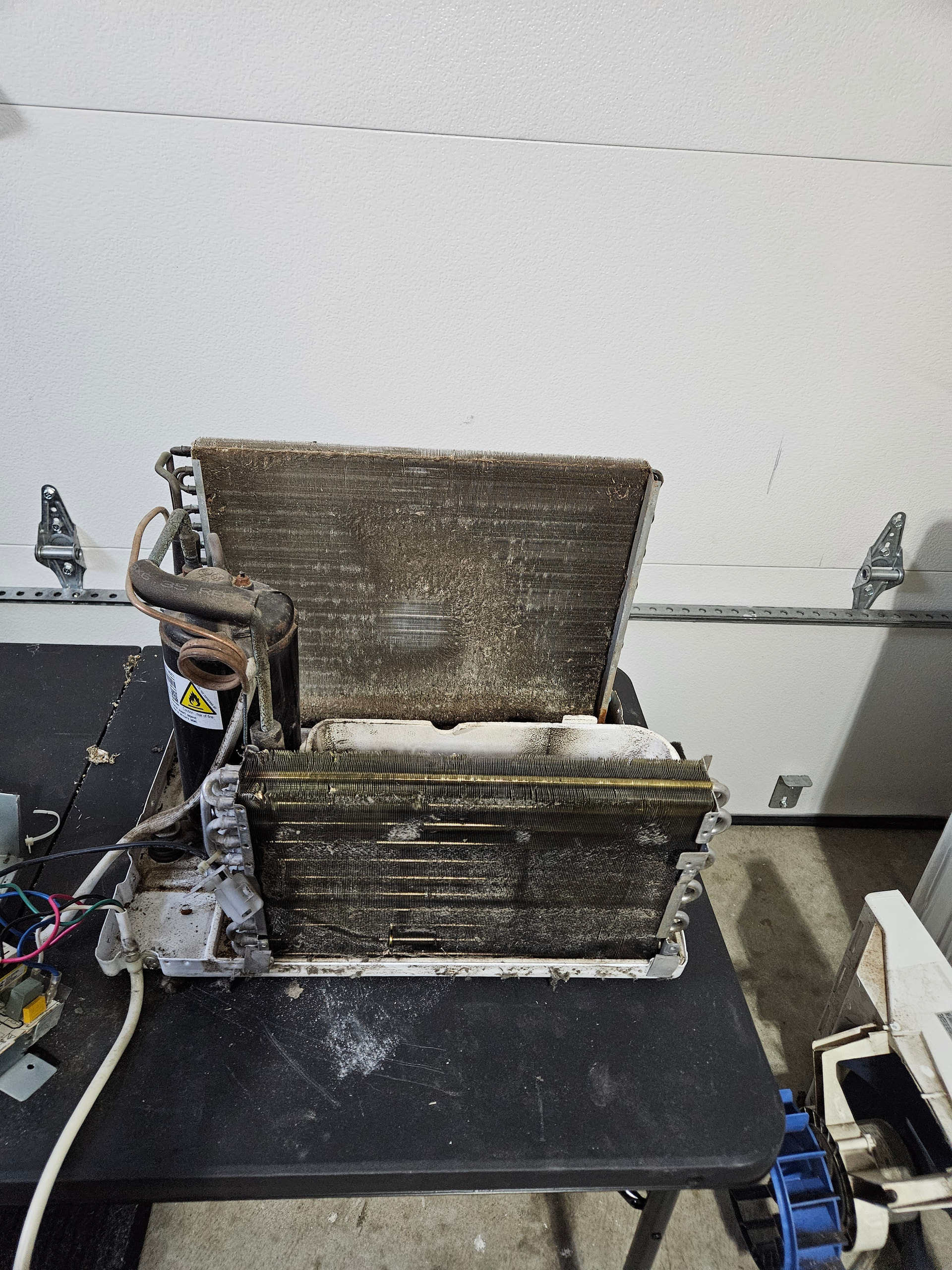

Wondering if it’s really worth to clean and disinfect. 8000 btu, around $200 or less to replace. Amazing how filthy it is after two seasons. :open_mouth: Saw a few YouTube videos and they came out pretty clean but do they really :thinking:

Clean it.
After hitting it with some compressed air the condenser frame is pretty much rotted out. Weird, I couldn’t find any drain holes in the rear of the unit where the gunk and rust is. I’ll have to pick up some of this Desolv for the next unit.:+1:
If the unit has a “slinger” fan blade in it there won’t be any drainholes at the bottom. This is to “improve” the efficieny of the unit by splashing the condensate on the condenser to cool it a little more via evaporation. The bottoms of the condenser coils always rot out on these units.
Nothing like “improving efficiency” to turn a product into a POS
Learned something today. :+1: Is the, “slinger” style pretty common? How do I determine if my next purchase has this feature?
Most, if not all window units I’ve seen in quite a while has this “feature”. They do it so they can list a slightly higher EER rating on the box in the store. Unlike years ago, most of these units are throw away items that are usually cheaper to replace then to repair and have a pretty short life expectancy.
Look for a drain hole. You can drill a couple holes to help it last longer. Try to drill from the top down to ensure you don’t hit a line!
Exactly what I did. Bought a window unit last year, and couldn’t figure out why the fan blade kept splashing the water, until I saw no drain holes. Drilled a few holes, and good as new, and the base doesn’t hold any water now, and get gunked up.
