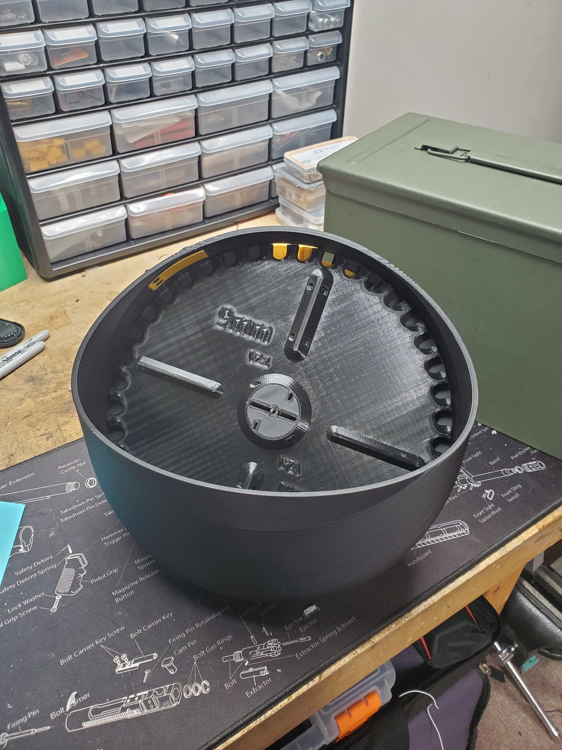

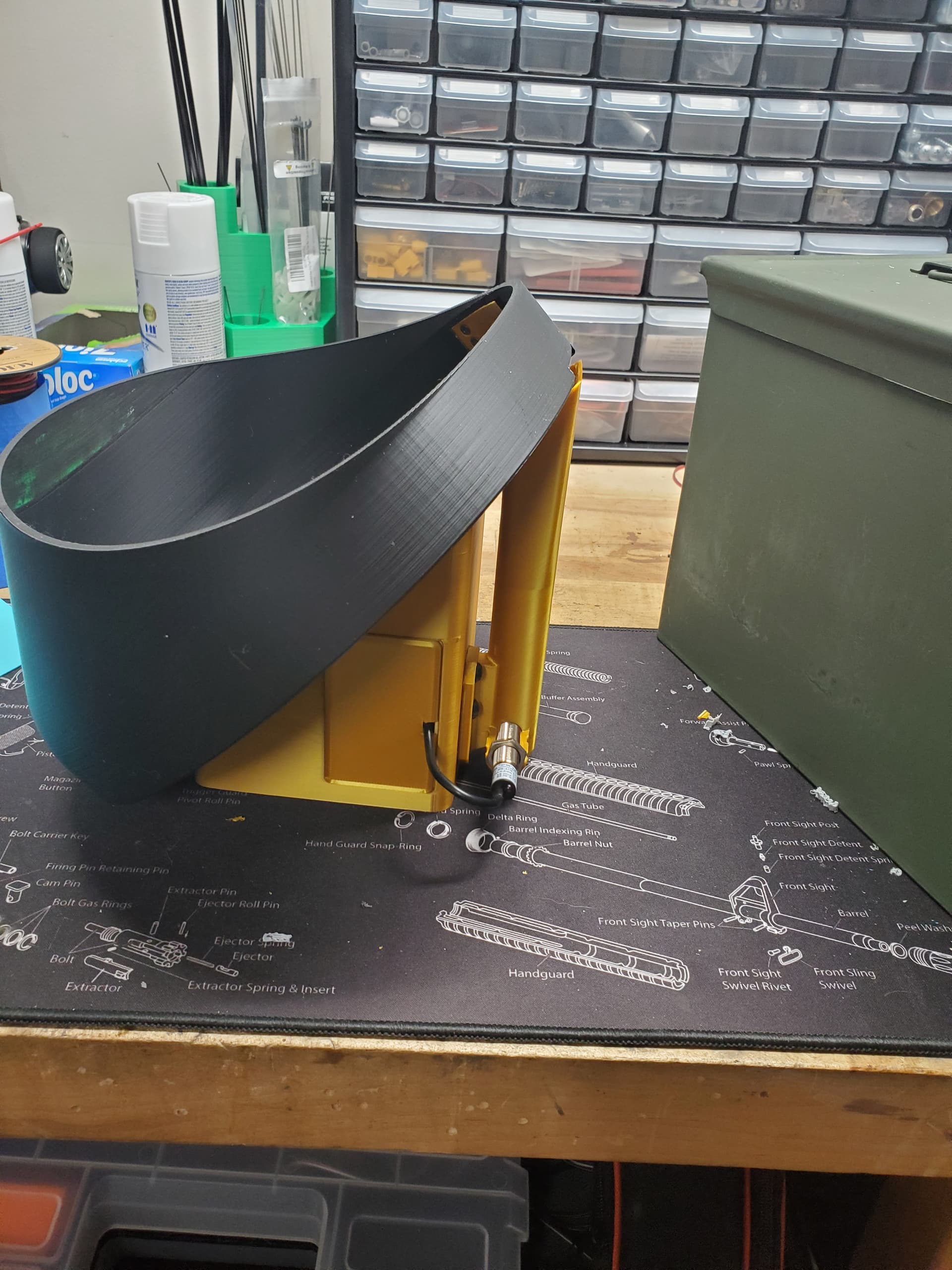

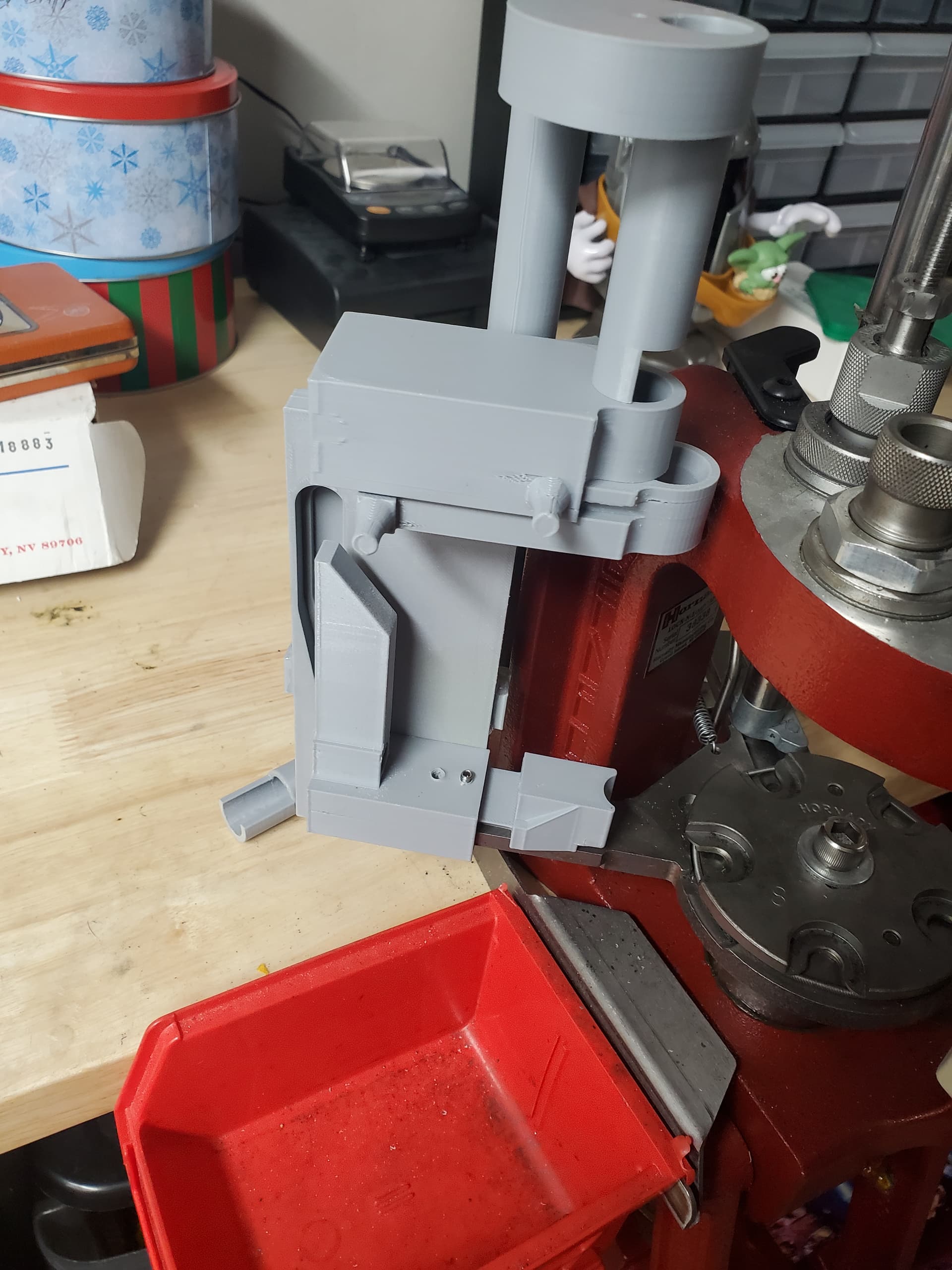

Everything is working, just need to figure out how to mate the auto feeder to the press feeder. Its sifting and dropping 9mm case without issues. I’ll have to figure out a plate option for .45acp, as they dont fit.
All in, the files were free, about 2 rolls of PETG at $21 a piece. $15 for the motor $8 for the sensor, $6 dollar 12v relay and a power switch. $12 12v power supply.
The rest if just miscellaneous hardware nuts and bolts and bearings.
Even if you had to buy assorted boxes of screws etc, this project comes out to less than 100 bucks.

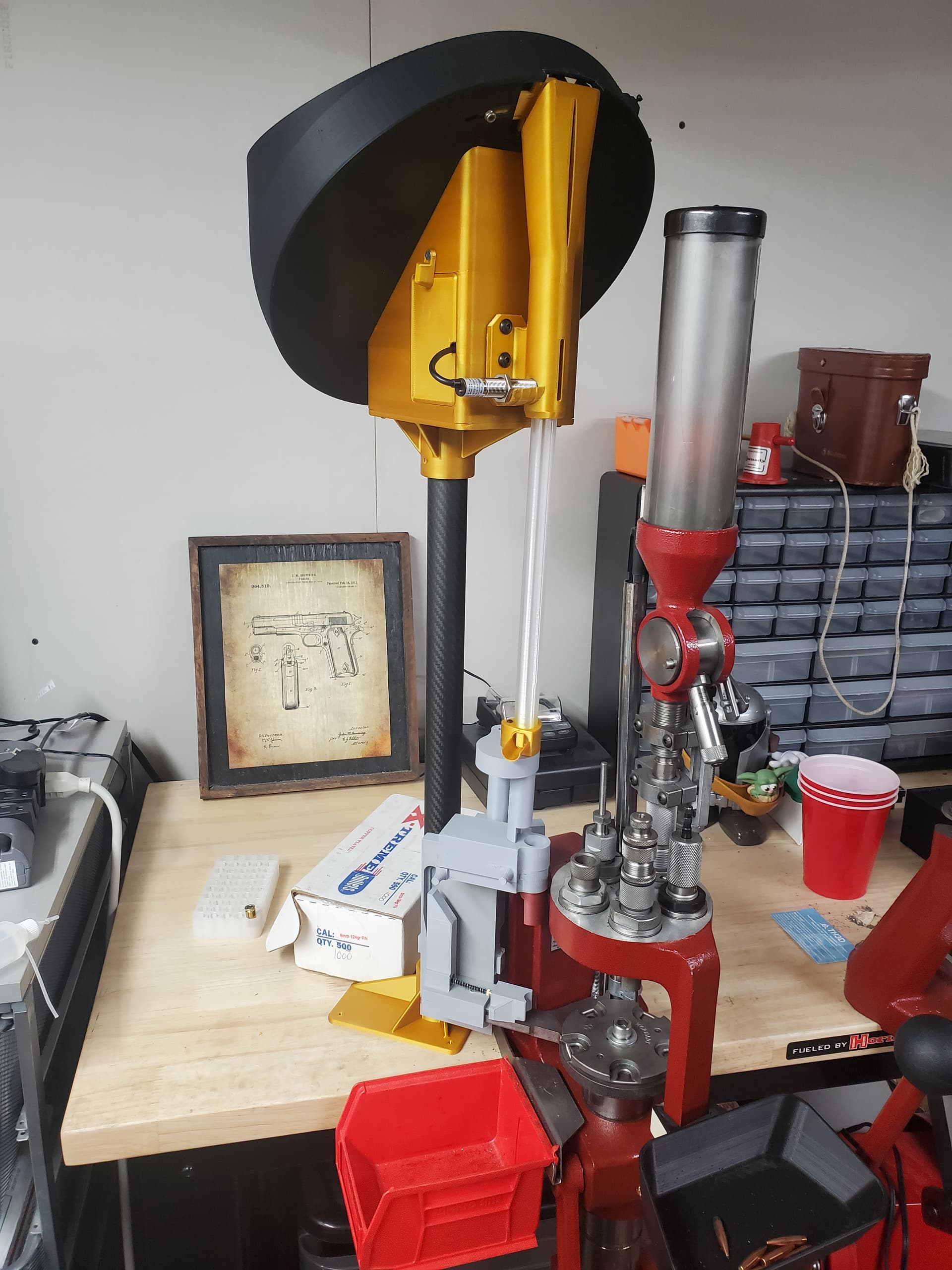

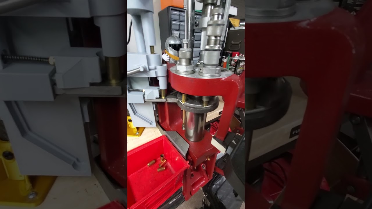

We’re cooking! Projected turned out to be rather easy, i even added a second sensor location to rig up a second sensor to empty the tube before turning the motor back on.
Looks like i will be cranking out some ammo this week. I got the lower sensor programmed using Arduino. Tube fills with shells and refills when emptied.
