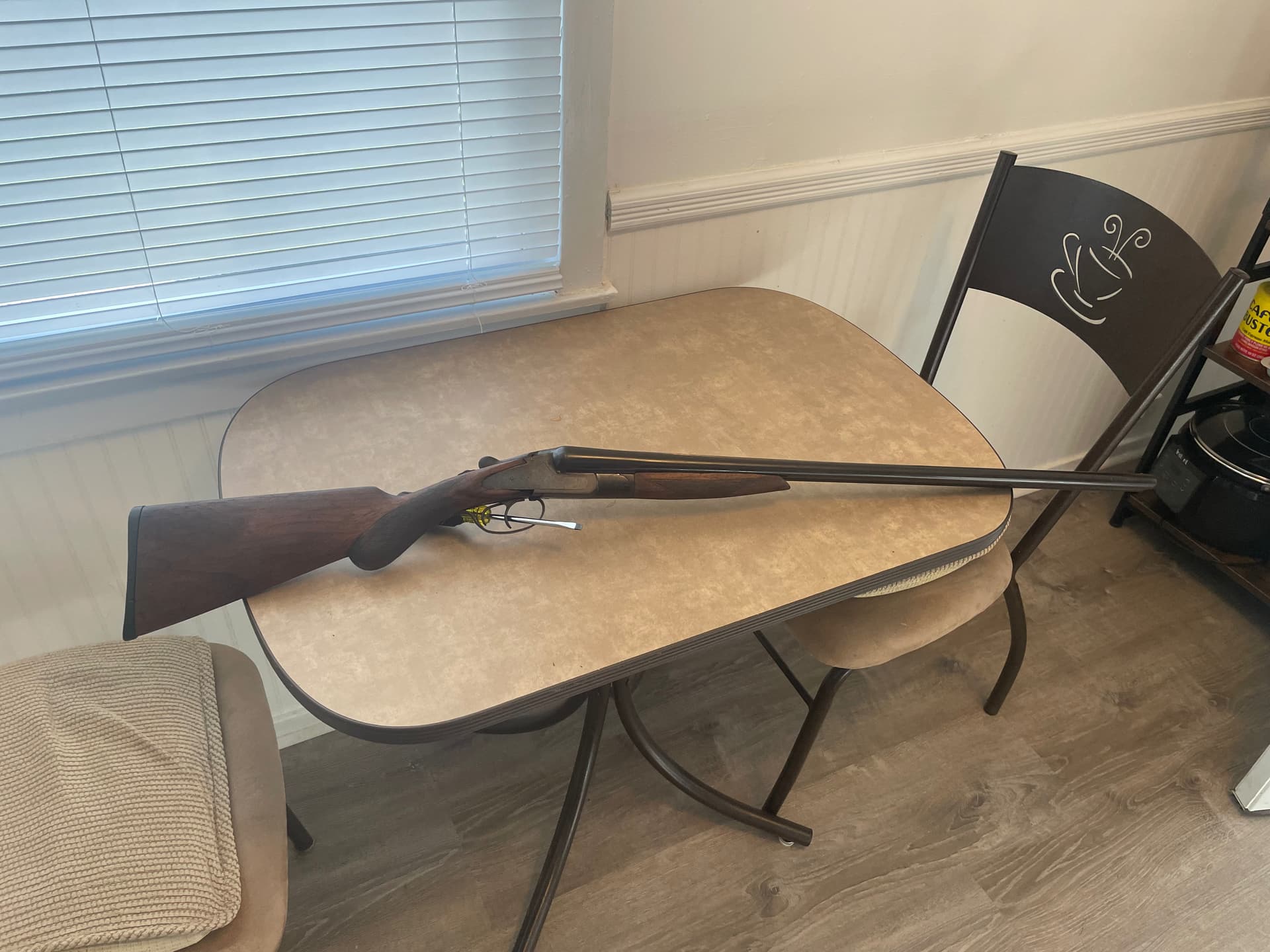

16ga project shotgun
I had a decent supply of 16ga laying around to burn, so when I ran across this Union Firearms Company model 22 side by side at a gunshow for $100 I jumped on it. Made in Toledo Ohio in the early 1900s. May look Lefeverish because Union Firearms Company employed Charles Lefever, son to Lefever founder Daniel Lefever.
Had a stuck safety but a good cleaning fixed that.
Barrel had a dent in it too. I found a socket that in fit the barrel perfectly but would get stuck on the dent. I used a cleaning rod and tapped it under the dent, then using a brass hammer tapped around the outside of the barrel around the dent. Magically the dent raised out.
Stocks took some sanding and I epoxied the cracks to try and prevent them from spreading.
I learned that the chamber is 2 5/8 rather than the 2 3/4 ammo I had on hand. May be a little concerning, but after researching studies by cowboy action guys on testing longer shells, and figuring that most short chambered shotguns are probably fired everyday with longer shells by people who never even realize it, I took the chance with low pressured bird shot ammo. Some feathering on the crimp of the shell due to the shell not being able to open up fully with the forcing cone, but no ill effects, and even patterned well.

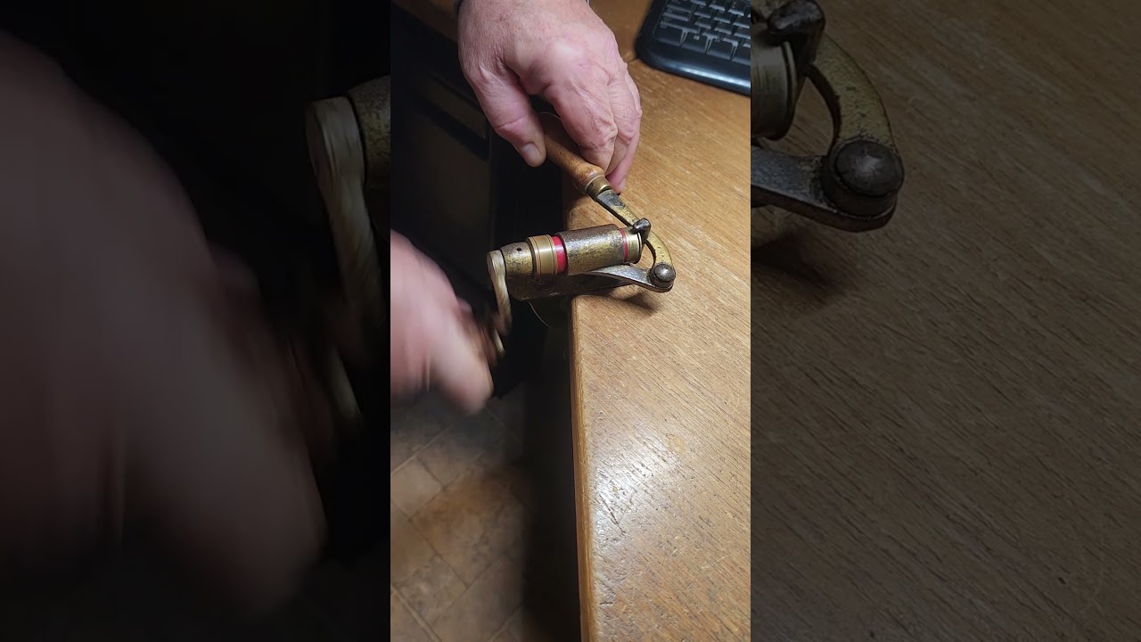

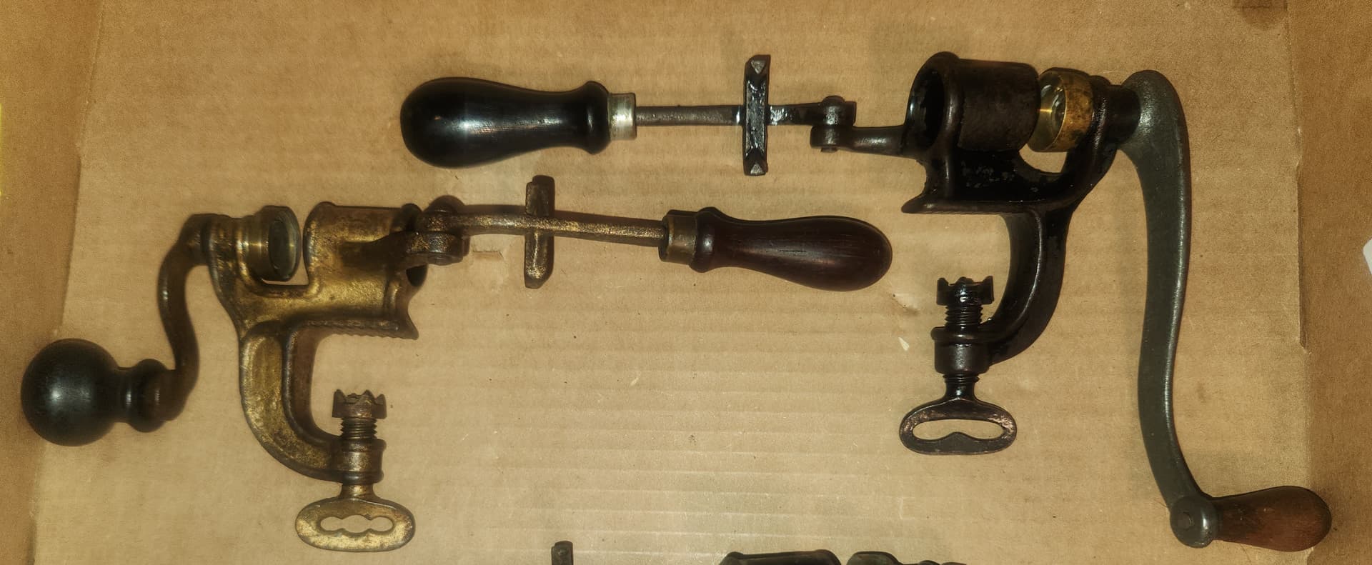

Cut down and roll crimp shells
Look what I just posted yesterday !!
Different but same crimper - I took this video to show how it works

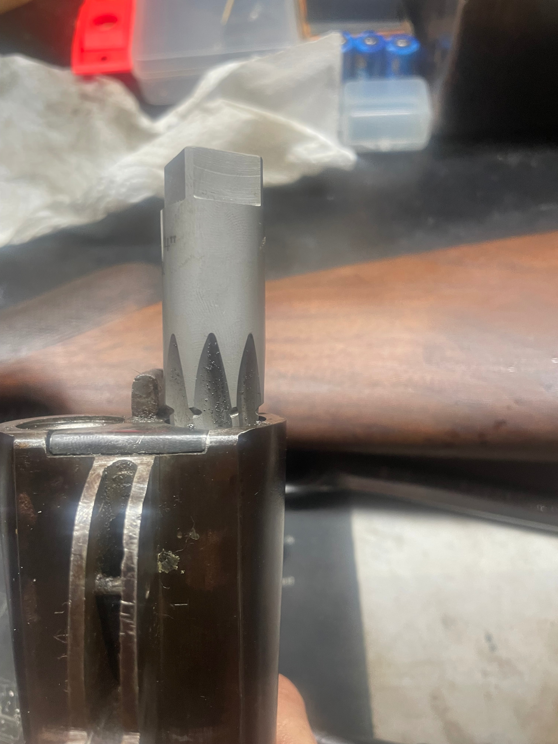

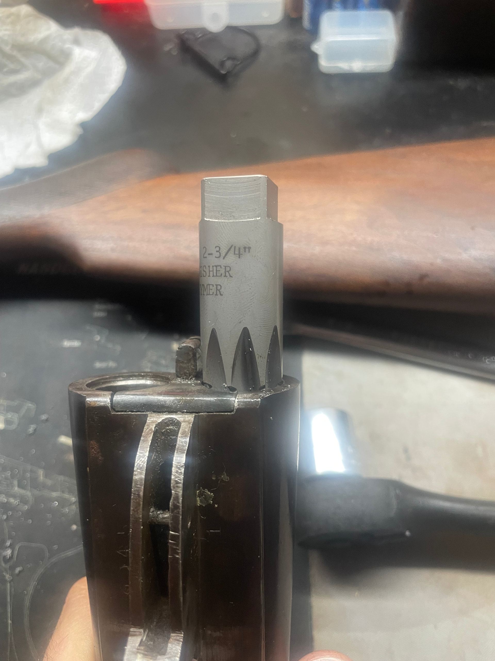

How much metal does that barrel have? Enough to ream it out?
How to Lengthen the Chamber on an Antique Parker Shotgun | MidwayUSA Gunsmithing
Going go rent reamer and give it a shot
Think the 12ga crimper will work on the 16ga shells?

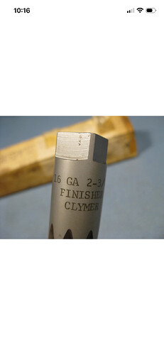

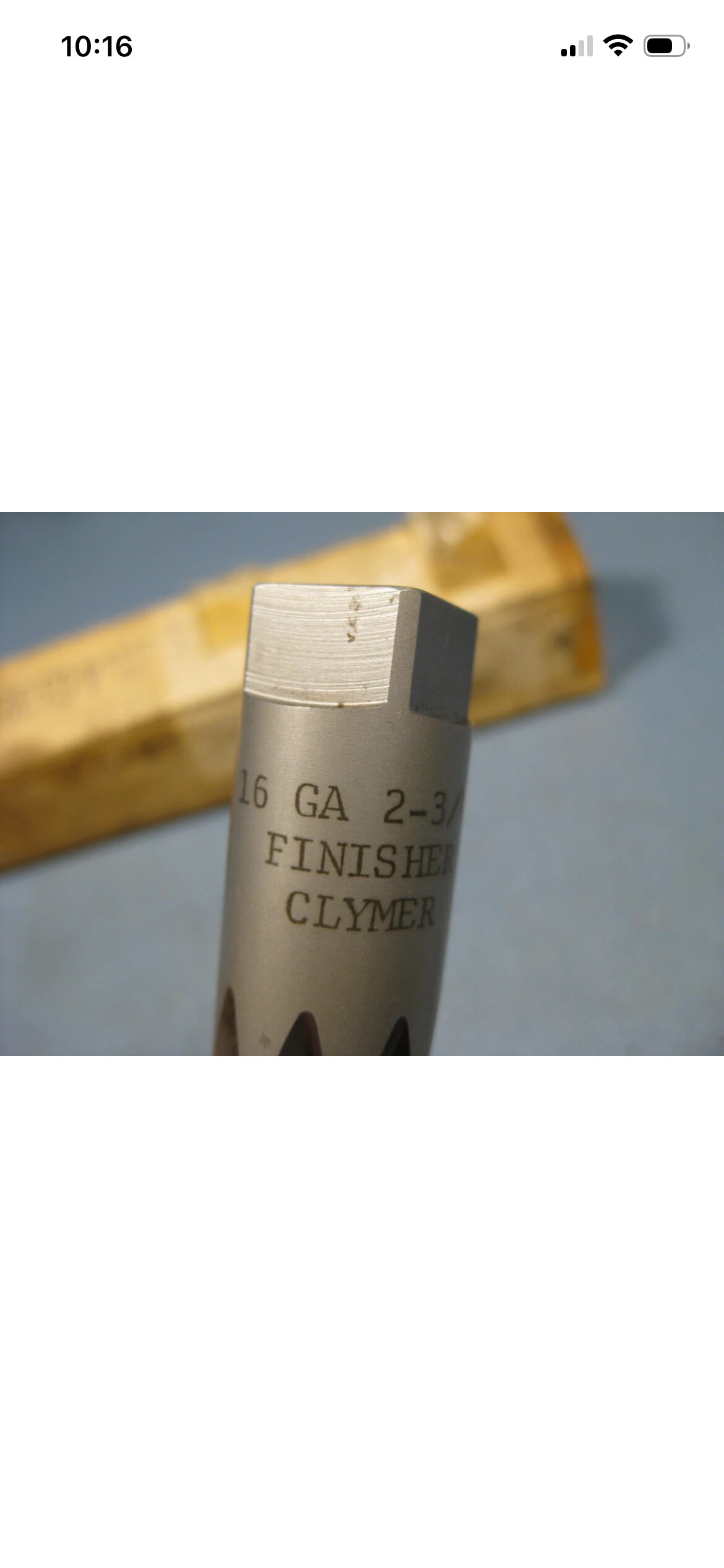

I ended up finding a 2 3/4 Clymer finish reamer on eBay and gave it a go after watching a 1 minute Larry Potterfield video. I think it came out great. Reamer is available for loan in case anyone needs to lengthen their 16ga.
Nice work, now you need to taper the forcing cones.
I’ve got a Chadwick & Trefethen inc 16 ga long forcing cone reamer on the way!
